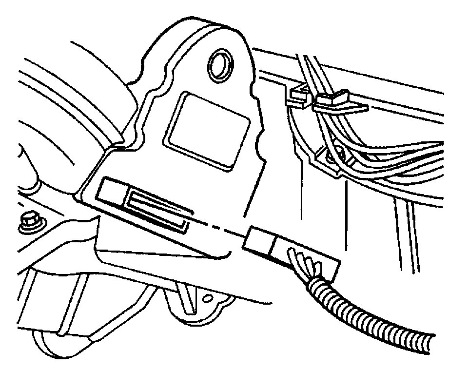

My vehicle has separate settings for passenger and driver climate controls. The passenger settings on the climate control unit seems to be not working because nothing happens when the lever is moved on the passenger side. To control the passenger side, the main levers above do the trick. How can I get the passenger side functions to work. Do I have to re-calibrate the climate control unit?

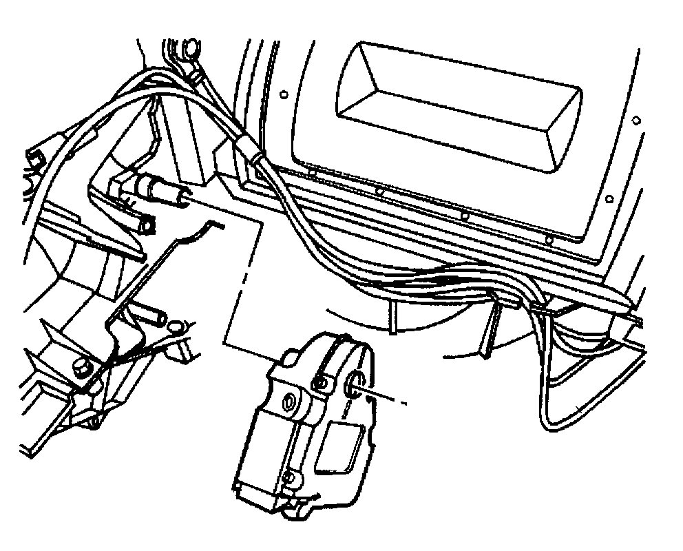

If the problem is related to the system not responding to temperature requests, it sounds like the blend air door actuator is the problem. A blend air door is responsible for the air temperature entering the vehicle. Since you have dual climate control, there are two separate actuators, one for the left and one for the right.
You can locate and confirm if the actuator is working by removing it and seeing if it moves when you change the temperature.
Here is a link that explains the common symptoms related to a bad actuator. Also, it shows in general how one is replaced.
Here are the directions specific to your vehicle. It is for the right side (passenger side) replacement. The attached pictures correlate with the directions,

REMOVAL PROCEDURE
pic 1
1. Remove the right side instrument panel insulator.
2. Remove the instrument panel compartment.
3. Disconnect the electrical connector from the RH temperature valve electric actuator.
pic 2
4. Remove the screws retaining the RH temperature valve electric actuator.
5. Remove the electric actuator.
