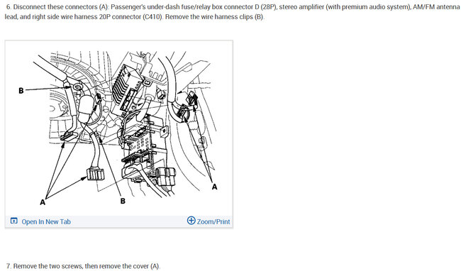

Hello! Just started recently, but the climate control buttons aren't working anymore. The lights will come on, but the vents don't change. When I press a button to change from floor to defrost to straight on, etc., nothing happens, no sounds, nothing. Is that a vacuum leak? Bad door motor? Something else?

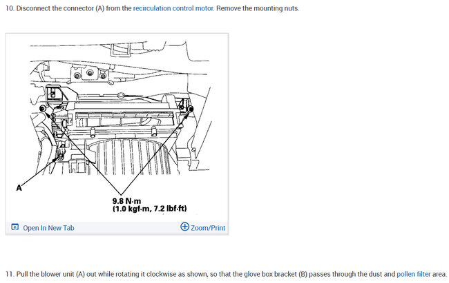

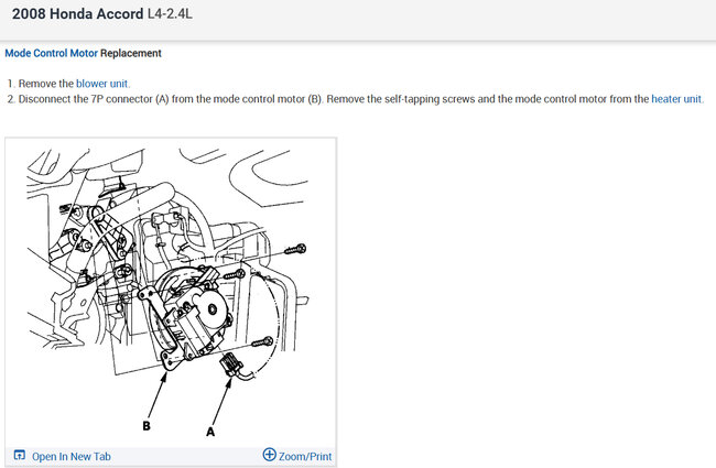

This can be the HVAC system controller or most likely the mode actuator. Here is the location so you can swap it out. This is what changes the vents. Check out the images (below). Let us know how it goes.

Thanks Ken. How involved is the process of getting to the point of replacing the actuator?

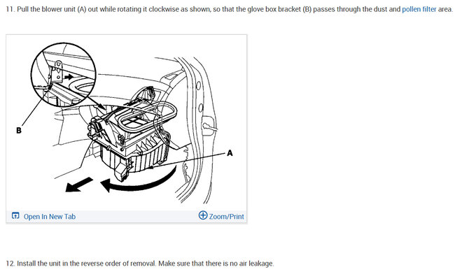

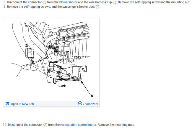

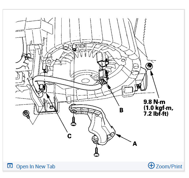

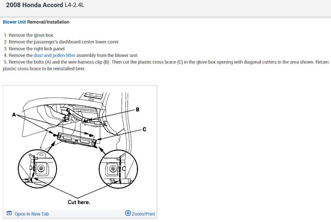

Good question, it looks like you will need to remove the blower unit housing to get to the mode actuator, here is how the job is done. Check out the images (below). Let us know how it goes.

Just following up; put a new mode actuator in and we're back up and running! Thanks for the assist.
