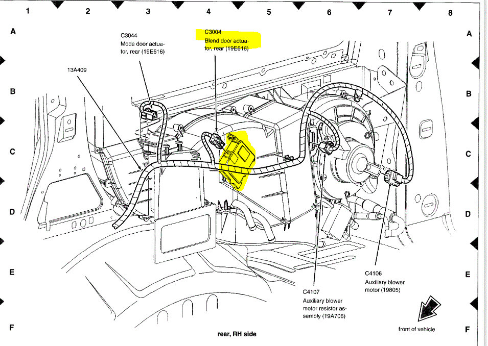

The roof vents for the passengers in the back are only blowing heat. No A/C or ambient air, strictly heat. The front dash blows A/C and heat the way it's supposed to.
Jul 8, 2022 at 8:39 AM
  • 110,248 POSTS

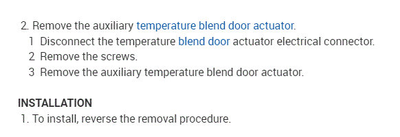

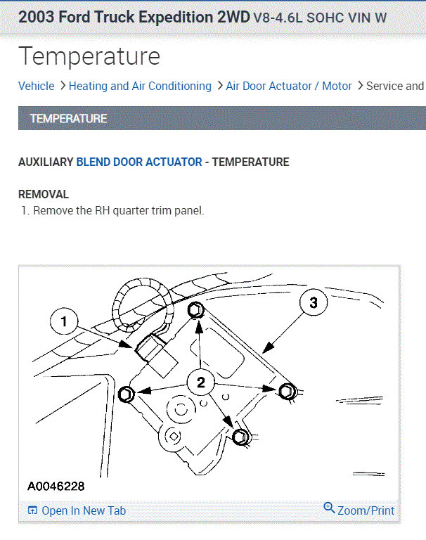

There is a rear blend air door actuator on this vehicle that has likely failed. This actuator is what controls the air temperature entering the vehicle.
If you look below, I attached the directions for replacing it. What I suggest is to remove it and while the electrical is still connected, see if that actuator reacts when you change the air temperature request.
Do this and let me know what you find.
See pics below. Pic 3 shows the actuator and location. It is on the passenger side rear of the vehicle under the plastic panel.
