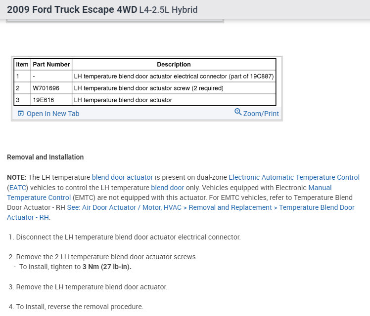

Hi , in cold weather now i turned on fan of my car ( AC is switched off )
And set temperature to max hot in both sides (passenger and driver)
But i noticed cold air comes to driver side and hot at passenger side , which is strange. I checked the fuse box in car to check climate control fuse and was intact , what is the cause of this problem ? And how i can solve the problem?

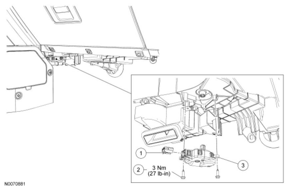

It sounds like you are having an issue with the drivers side blend door actuator.It is a small electric motor that diverts air flow through the specific vents. Here is a tutorial showing what is involved to replace:
I've attached step-by-step picture instructions below on how to replace and its location. Hope this helps and thanks for using 2CarPros.

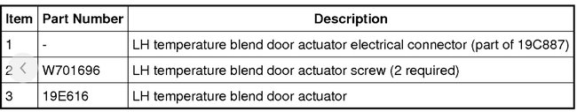

Can you tell me what parts that i need to get ?
Is the passenger actuator part number same to driver one ?
I found these parts:
( 8L8Z-19E616-D)
(AR3Z-19E616-D)
Which one fit the driver side ?

I have problem in driver side which blow cold air despite i set temperature to max hot, while passenger side is okay.
I asked and told door blend actuator problem. I want know what is the part number that is defected? I am confused from numbers as all actuator have same number expect different letters.
I found (19E616D)(19E616C).
Others A,E , so which fit my hybrid car?
Also you sent the way for change actuator which is behind the glove-box but the driver side is the defected. can you show me exactly what is the location of the driver actuator and demonstrate by graph the location of it?

DANNY L
  • 5,648 POSTS
Hello again.

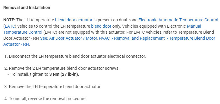

The left and right hand actuators are the same part number . It is your correct p/n number 19E616. Here is the step-by step replacement instructions. Hope this helps and thanks again for using 2CarPros.
