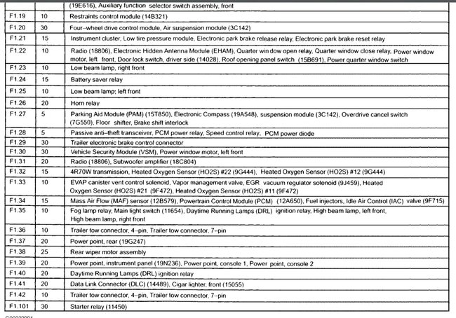

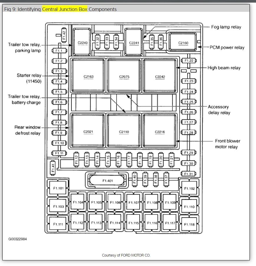

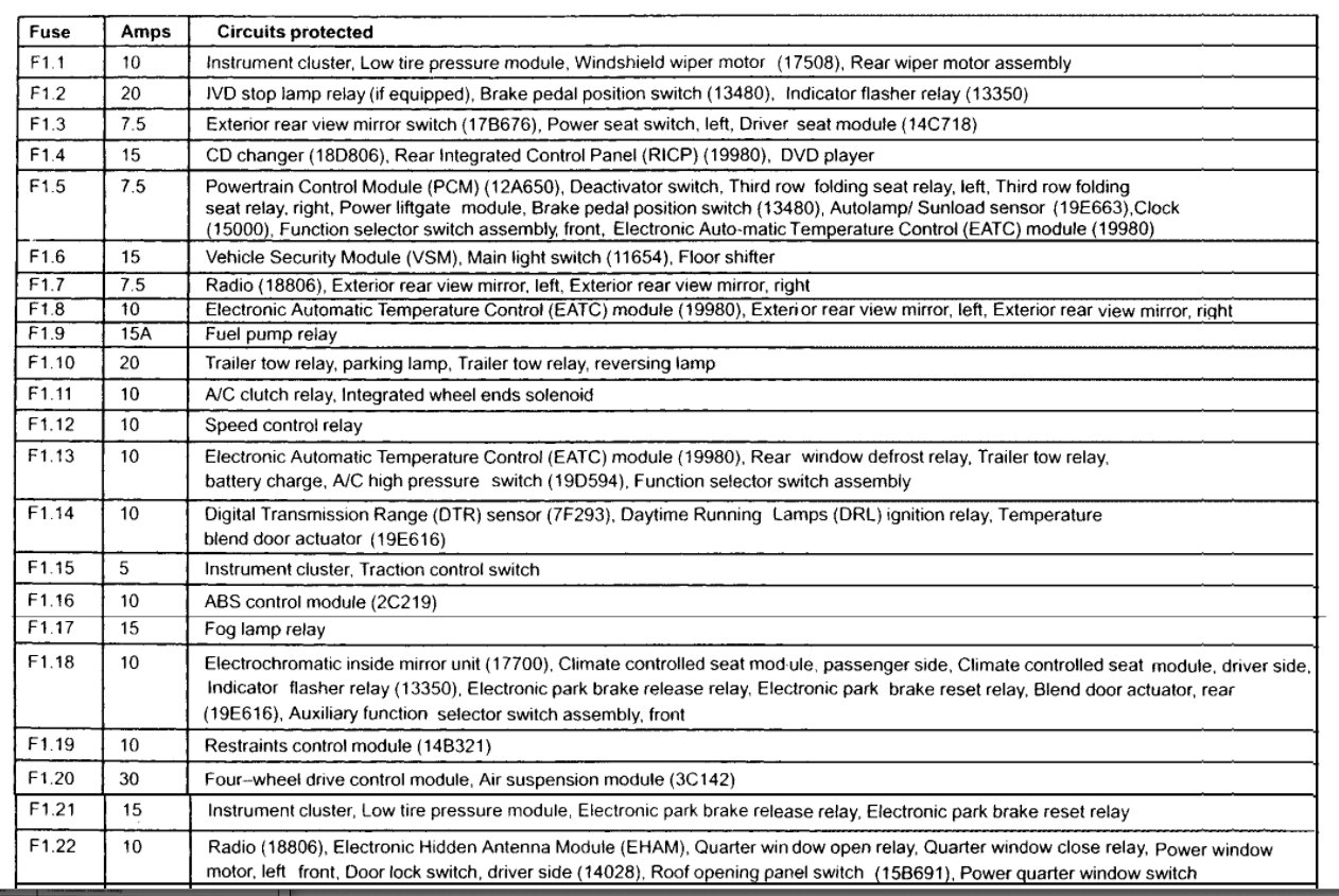

Climate control went out but rear defrost light comes on.
Jul 15, 2017 at 2:31 AM
Experienced Mechanic
55,649 POSTS
Lets start by checking the fuses for the system.
Here is a guide to get your started.
