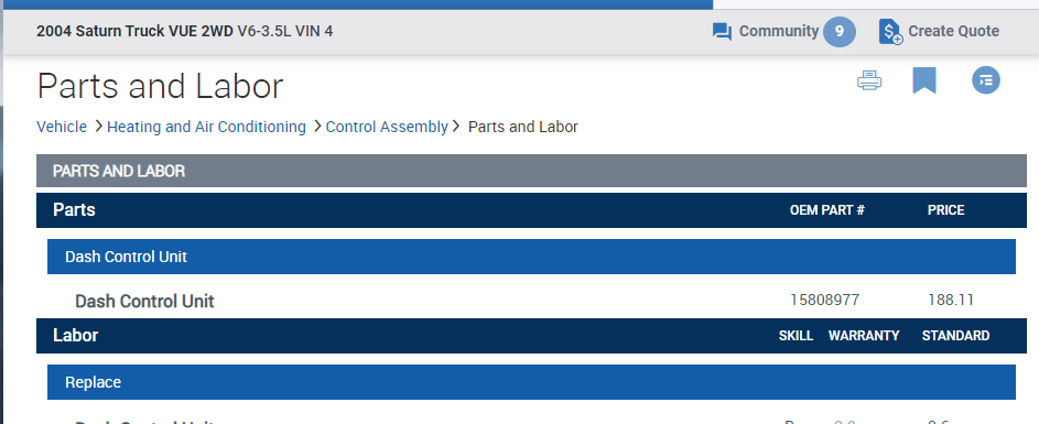

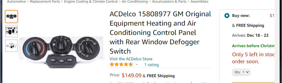

I am attaching the part information for this panel. If you search for the part number, there are many available as it is a generic AC Delco part so you just need the correct part number.
I also, attached a screen shot of one available just to show they are out there. Let us know if you have other questions. Thanks

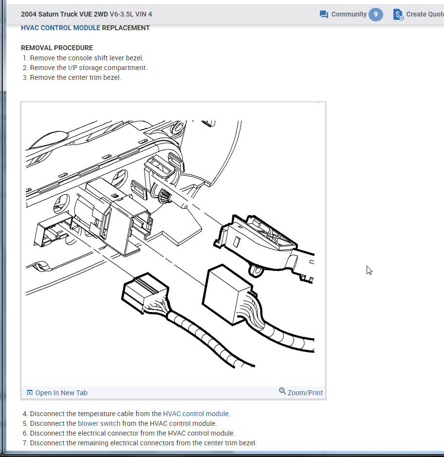

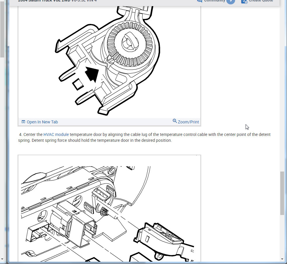

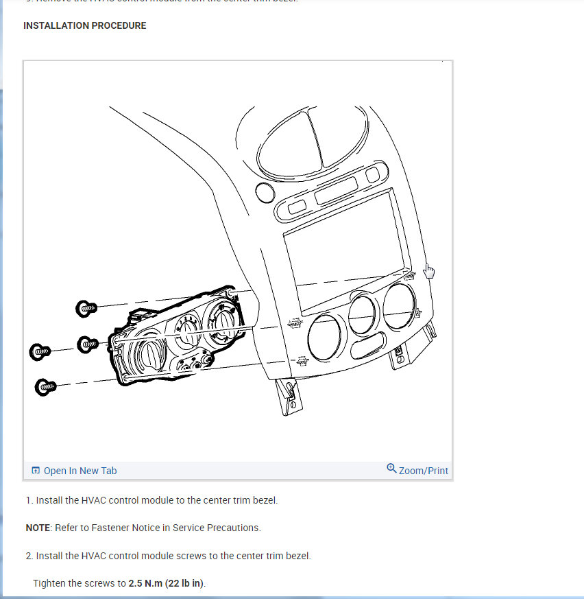

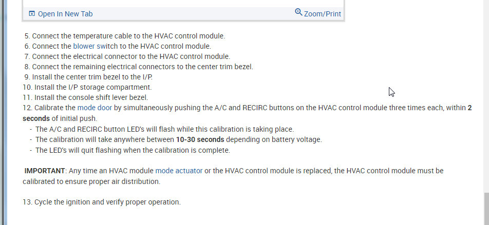

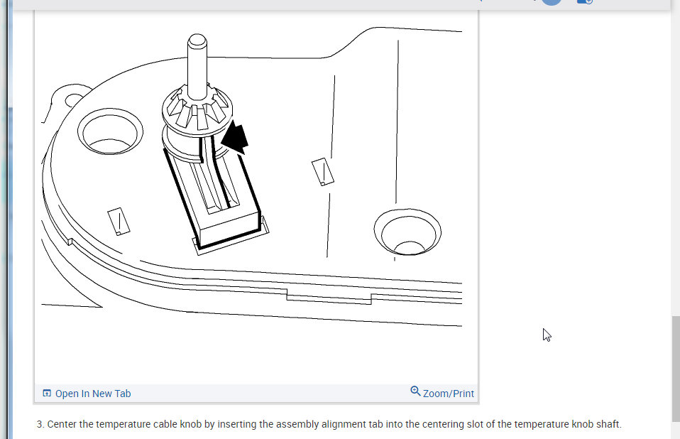

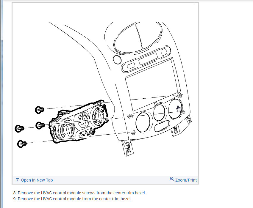

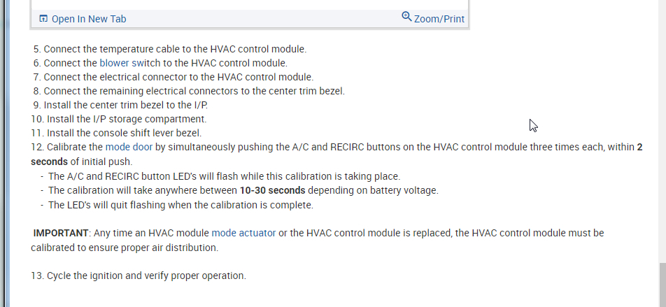

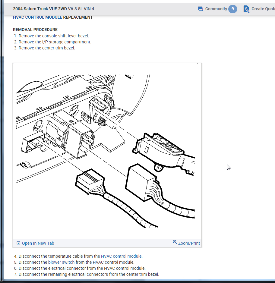

Apologize for not providing this previously. Here is the replacement process in case you need it for the HVAC control panel.
Let us know what other info you need and we are happy to provide it. Thanks
