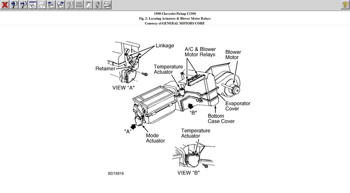

When replacing a stripped blend door actuator, and after wires connected, the actuator motor will spin 360 degrees and will not stop. When it's started with power it rotates and even sometimes with no power on the actuator. I think it might be the control panel. Tell me what you think please.

Is this with the actuator in the car or out of the car?
When it is installed, it will learn the sweep once it is commanded.

Yes and no, I removed the old one and plugged in the new one. I left the actuator loose and in my hand. It would rotate 360 degrees constantly and intermittently rotate even when power was not applied. Since I took apart the other actuator I know that it consists of only a simple motor and gear set. It has no means to stop running unless it is given a command, it does not rotate into closed and stop as it should.

Mount the actuator and see what happens.

It srtipped out another actuator when I did this.

This sounds like the control head as that is what controls the signal to the actuator.
You will need to replace them together or at the same time. Install the actuator before testing it. Do not test it off the door.

No signal goes to this motor. Power is the only thing it operates off of. The "signal" is merely an input demand that the driver dials in the control head coordinator give the required voltage to the motor so it can make minute motor movements. So, if you have a bad control panel and your unmounted motor spins and never stops, if you mount it with these full inputs, it strips out.

Power is the signal. When you command the door to change, a signal or power is sent to the motor to work in the direction of the command.
