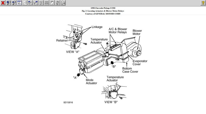

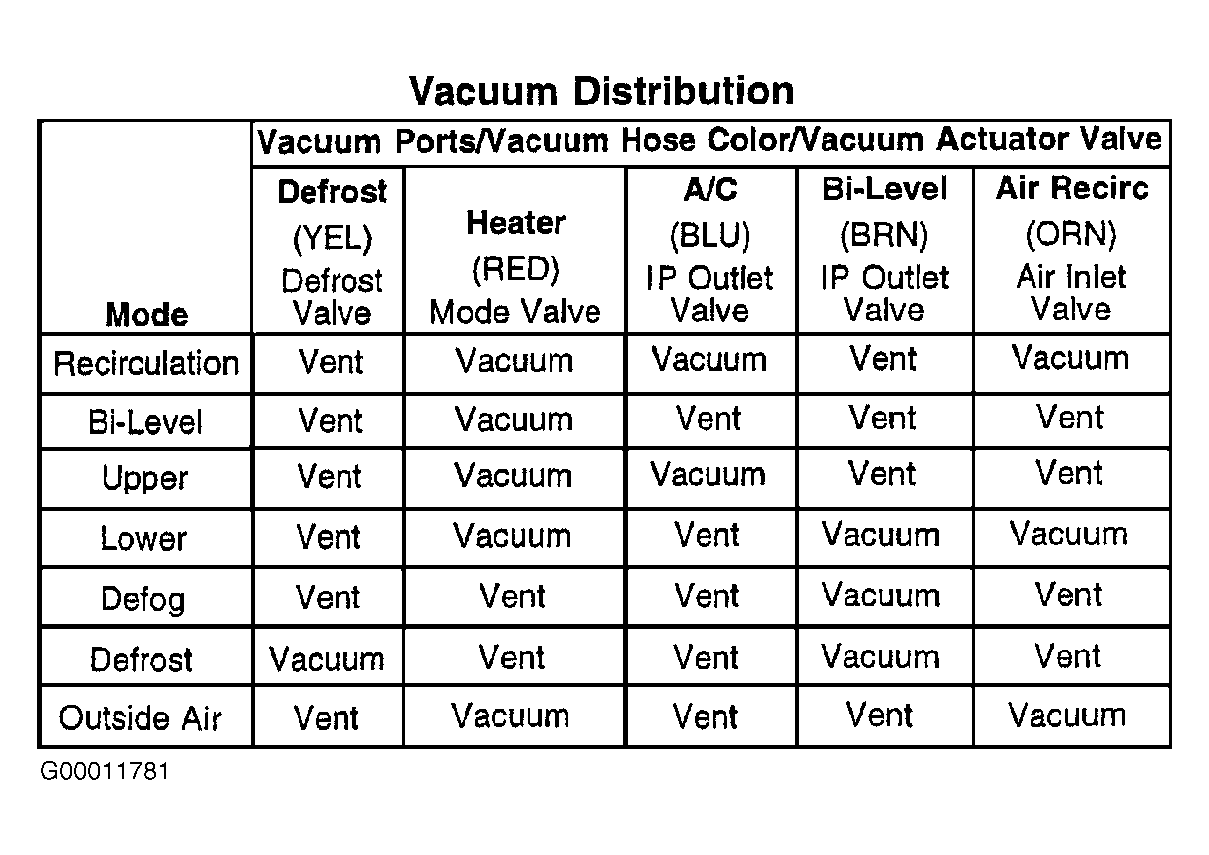

2000 Chevrolet Impala heater direction not working. Control panel is new. Doesnt matter if you put on deforst, floor or face it blows out floor. I was told there is a servo motor that is located in the dash and very difficult to get to. Where can i get instructions on replacing this part?
Mar 13, 2019 at 10:38 AM (Merged)
  • 110,241 POSTS
The 2000 HVAC is actuated by vacuum. Check under the dash for disconnected, damaged, or broken vacuum hoses. I have attached a list of where the vacuum hoses go to help. Let me know what you find.
PS: It isn't real easy to check these. They are up and under the dash. If you are lucky, with the engine running you may hear a hissing sound that would indicate a leak.

I have a 2001 impala and when i have the heater on it only works on defrost, when i move the selector to a different position it does not change. any ideas what this might be?
BLUELIGHTNIN6
  • 16,542 POSTS
Hello
Thanks for the donation
It sounds like you may have a vacuum leak. Check under the hood for a disconnected or damaged vacuum line. The controls are vacuum operated and if the vacuum supply is cut off the system defaults to defroster only. Some vacuum lines may also be located inside of dash.
