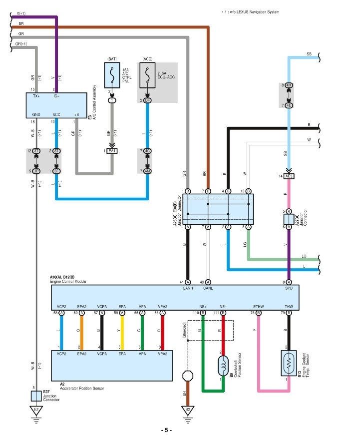

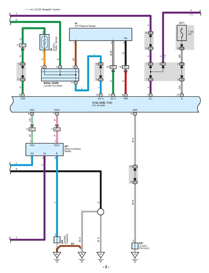

The A/C climate control isn't working. I have checked all the fuses but haven't seen anyone that has gone bad.
I will need a full diagram of the climate control wiring schematic, I hope anyone helps me out please.

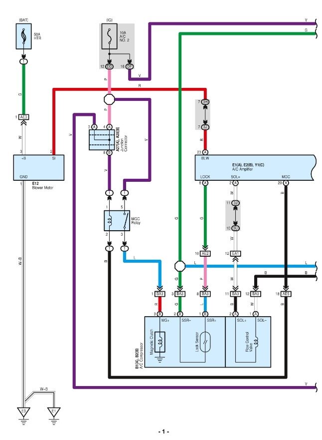

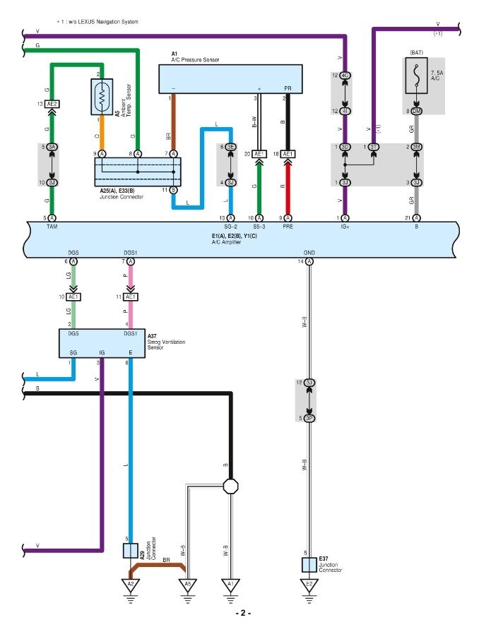

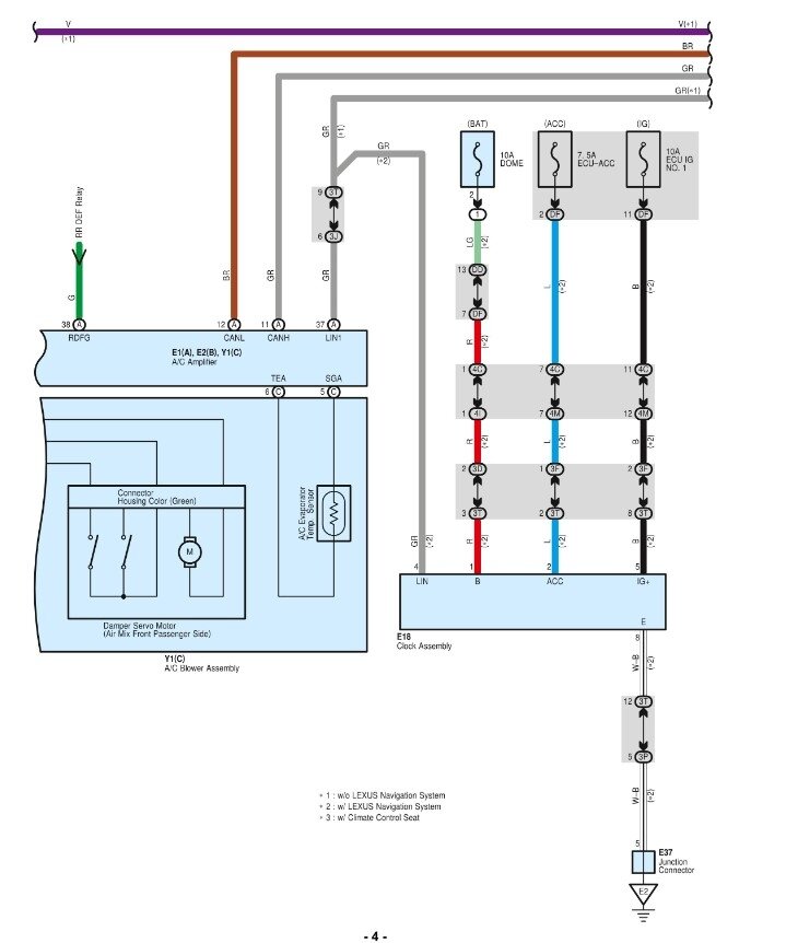

Does it power on at all? There are a few fuses to check, grab a test light and check to see if you have power on both sides of the fuses just to be sure there is power to the fuses.
Check the 10-amp AC2, 7.5-amp AC, 15-amp AC control, 7.5-amp ECU ACC
If those fuses all have power on both sides but still no power or control action, you will want to pull the control head out so that you can get to the powers and ground on the back. As a start here are the wiring diagrams.

thanks, I have checked all fuses as instructed there are okay, the image IS blurred I can't see it all clearly, I wish you can make it in pdf FILE, thanks for the assistance.

pdf isn't allowed on here unfortunately. The pictures are clear on my end, do the thumbnails open when you tap them, they should open to full page images.
