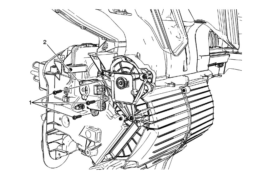

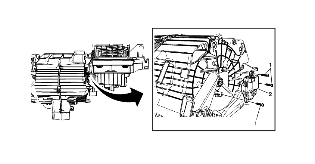

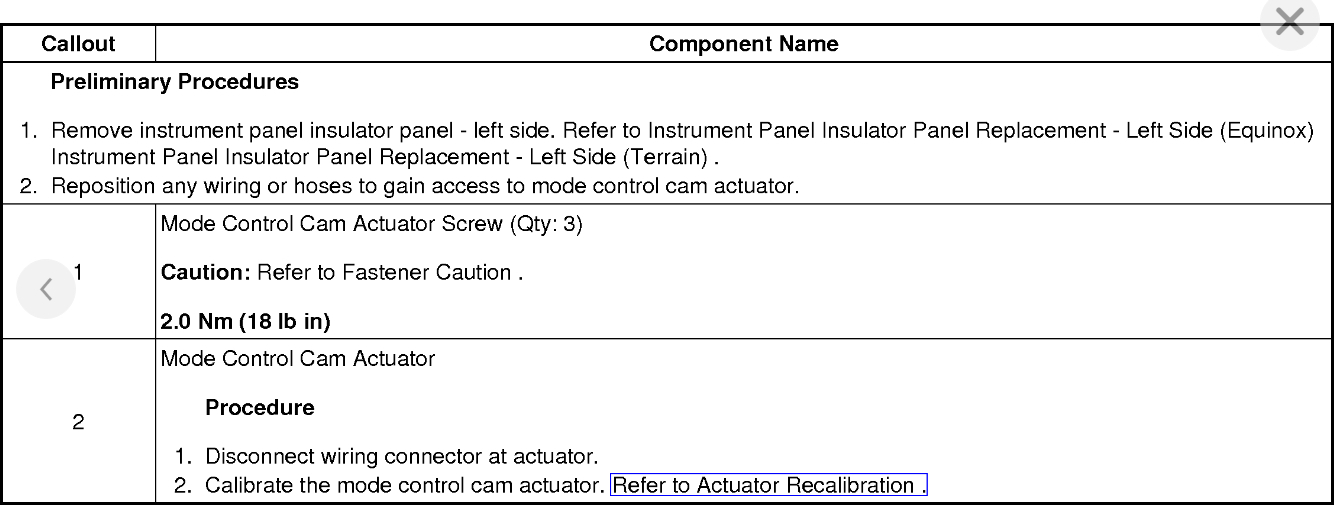

Good evening.
It sounds like the actuators are not working.
The one for the mode I will attach the procedure for you.
The cold and hot, are you sure the AC system is working? Does the compressor engage? Did you check the Freon pressures?
The mode door is on the left side of the under dash.
The blend door is on the passenger side under dash.

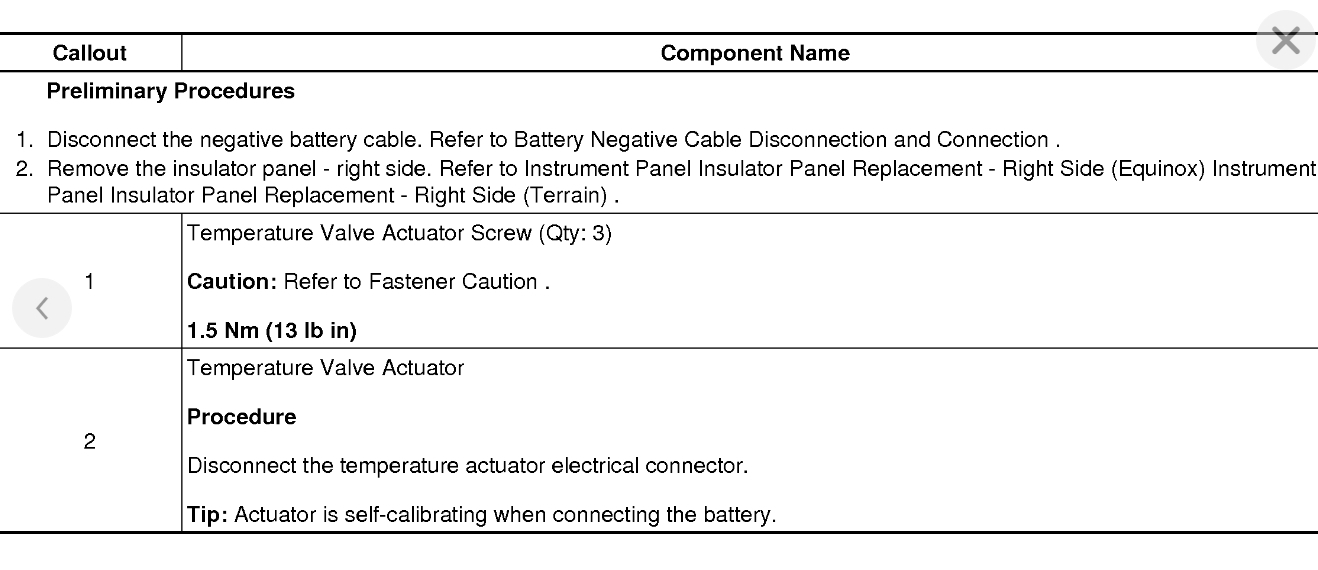

Thank you for your assistance. I finally got time to work on my vehicle. The mode door is not jammed it is easy to move by hand but the mode actuator does not move when removed from the door. The blend door is also easy to move, and its actuator clicks and barely moves. I will be replacing them both. Is there anything special I need to do when I replace them? A calibration procedure or something? I have read a few posts that mention something about such a procedure.
Aug 21, 2018 at 2:06 PM
Yes, replace them both.
Then you need to calibrate them.
Remove the fuse for the AC for four minutes. Then install the fuse and turn the key to the on position. Let it sit for another two minutes. The control module will calibrate the actuators.
