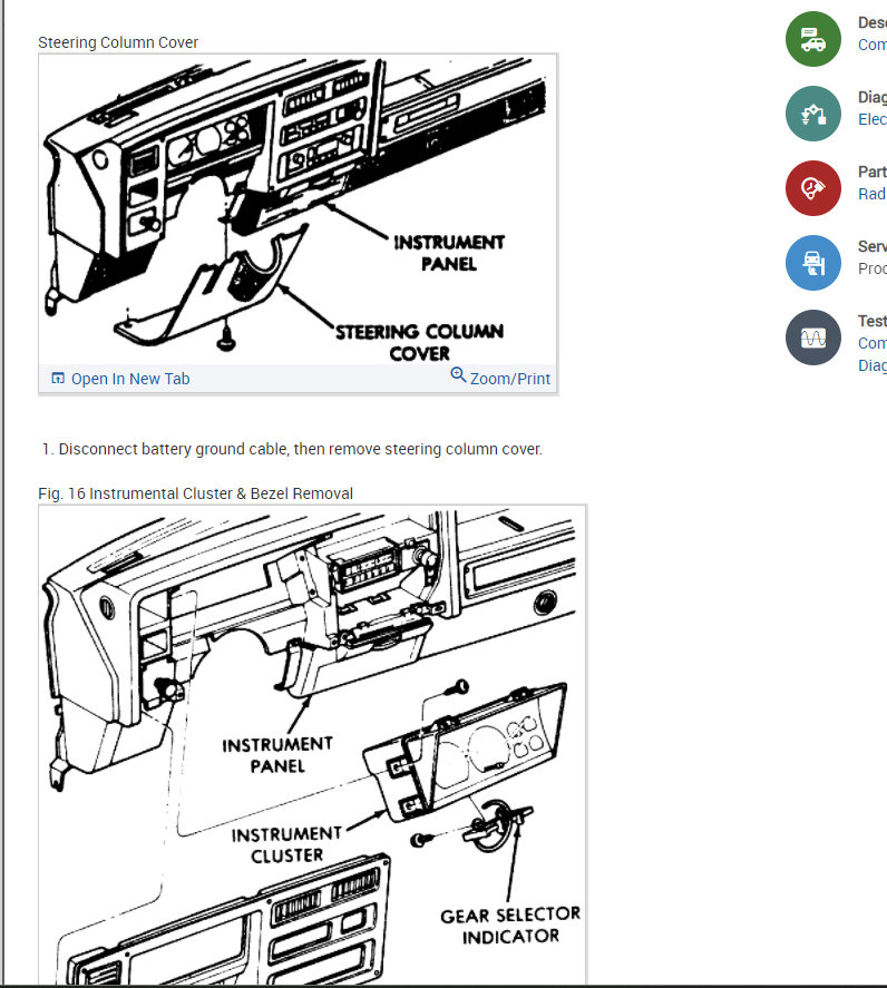

I need to no how to replace the unit but nobody can tell me?
May 23, 2021 at 9:00 PM

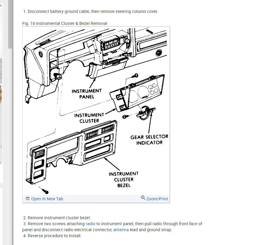

You need to remove the bezel that covers the radio, control panel, and cluster.
Once this is removed you will see a couple of screws that hold this in place. Then you just slide it out and disconnect the connectors on the back.
Please see the attached info below for more info on this. Let us know what questions you have and we can go from there.
