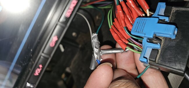

I notice that the dark green and grey wire was cut, most likely cause the blower motor was just running and the previous owner didn't know what was wrong, so he instead cut them to shut off the blower motor, I currently have them wired back up and that when I noticed the blower just blowing none stop.
I checked all voltage and ohms, everything reading right all the way down to the resistor but nothing from resistor to blower motor.

I have wired a new wire in the grey/black control wires place and now I'm getting a reading now and when I first connected the new wire, I heard the fan kind of start low blowing and turn off, but now that I have everything connected and tucked away, now I'm still getting no fan blow on any speed.

I see in the images the wiring to the HVAC controller seems to be repaired, this can be the problem, I would use this guide to check the continuity of each wire and make sure none are shorted to ground.
This guide can help:
Also check the ground and power to the HVAC controller. Check out the images (below). Let us know how it goes.

Okay, thanks for all the help. Found figured out the grey/black ground and Blower Motor controller was swapped, not allowing the blower motor to get a signal and the control module to get(D10).
