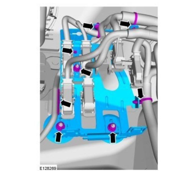

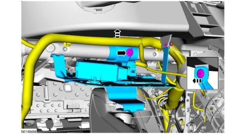

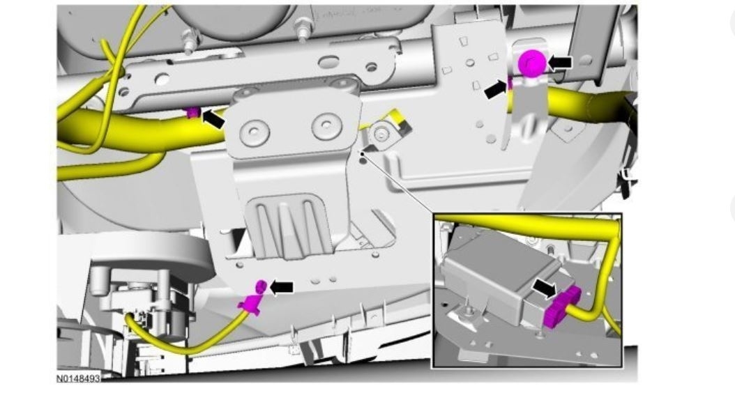

1. Remove the accelerator pedal.
2. Remove the BCM (Body Control Module).
3.
- To install, tighten to 15 Nm (133 lb-in).
4.
- To install, tighten to 8 Nm (71 lb-in).
5.

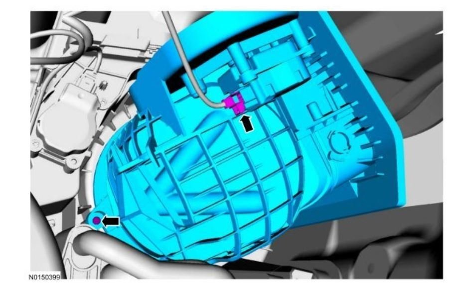

6. Disconnect the air inlet door actuator electrical connector, and remove the front air inlet duct retainer.
7. Install the ratchet, extension and socket as shown. Remove the upper air inlet duct retainer.
8. Install the ratchet, extension and socket as shown. Remove the lower air inlet duct retainer and the air inlet duct.
9.
10. Release the retaining clip holding the blower motor while an assistant from the passenger side compartment reaches through the blower motor cage and turns the blower motor housing 45 degrees clockwise to release and remove the blower motor.
