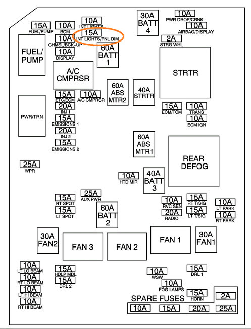

Hello, my climate control lights are out and i cannot find any information if this could be a fuse or just the bulbs. I also read somewhere that i might have to replace the whole climate control component. Can you help?

That most likely uses an LCD display that no longer works. That would mean replacing the whole control head.

found out it was 15a fuse that was blown. My question now is it keeps blowing is there a place i can get a free schematic/wiring diagram of the int panel/dimmer circuit?

https://www.2carpros.com/images/external/155623454.gif

Thank you. I am really confused though because in my car the only thing that 15a fuse controls that i can tell is the lights on climate control and the trunk light.. the trunk light i dont even see on there. Am I looking at this wrong?

You asked for the diagram for the dash light circuit. What you really needed was the diagram for that particular fuse.

Give me the fuse name or number and the location.

15a interior lights and panel dimmer...

That feed goes directly to the BCM and it takes it from there. Going to be hard to track. https://www.2carpros.com/images/external/216861006.gif
