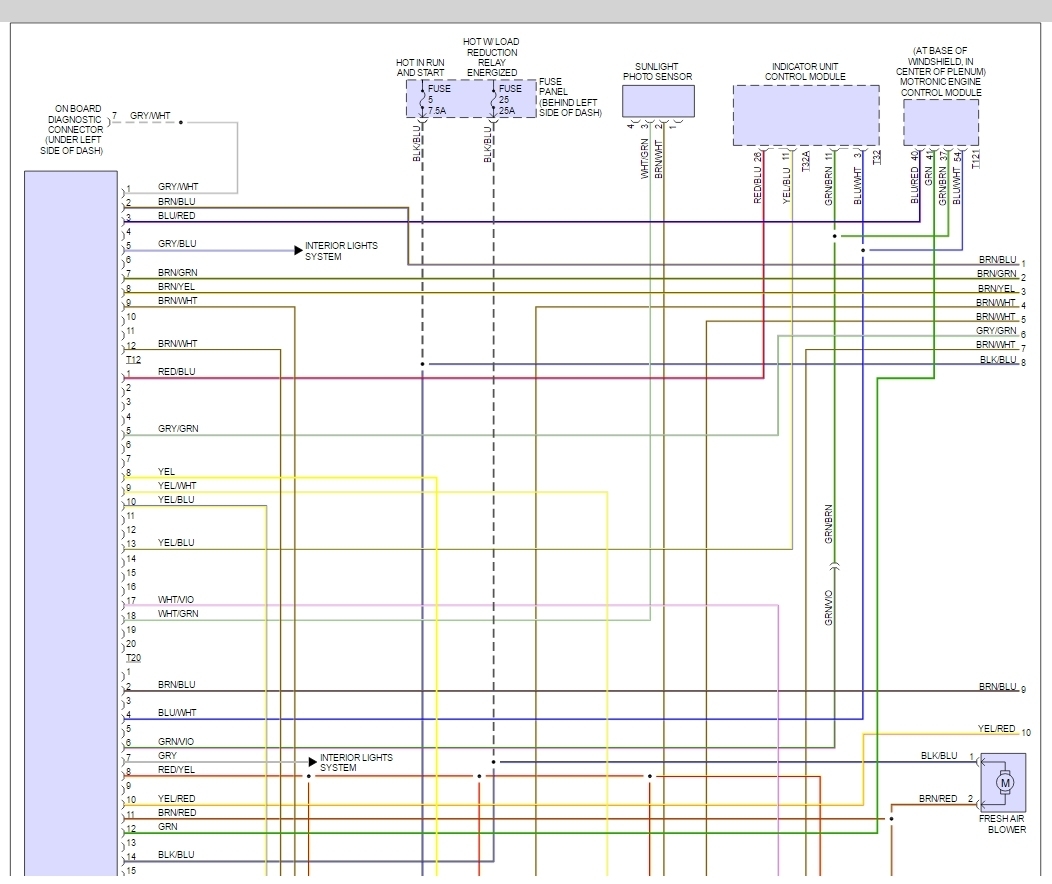

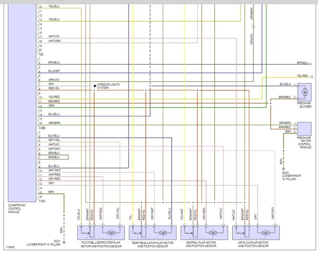

Bought the car been setting 4 approximately 2 years. No Heating no air conditioning no defroster no blower nothing. Need fuse box and relay box diagram. Is there anyway to check the relays out of the car? I bought the repair manual but the relay box diagram is not in it. Please help thank you
Sep 8, 2016 at 4:23 AM
  • 55,560 POSTS
There is no way for the heater to work if the blower is not working, here is a guide and a diagram to help you.
https://www.2carpros.com/articles/blower-motor-testing
the diagram is below
