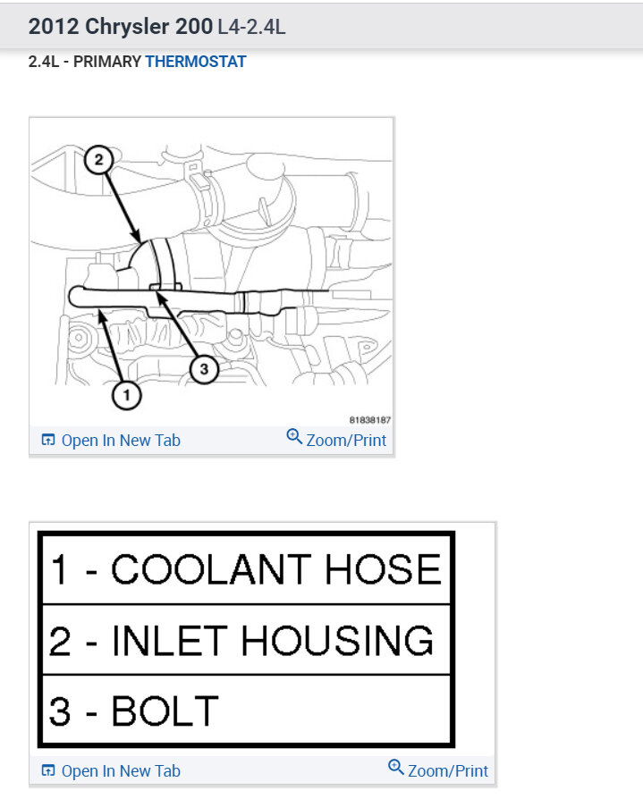

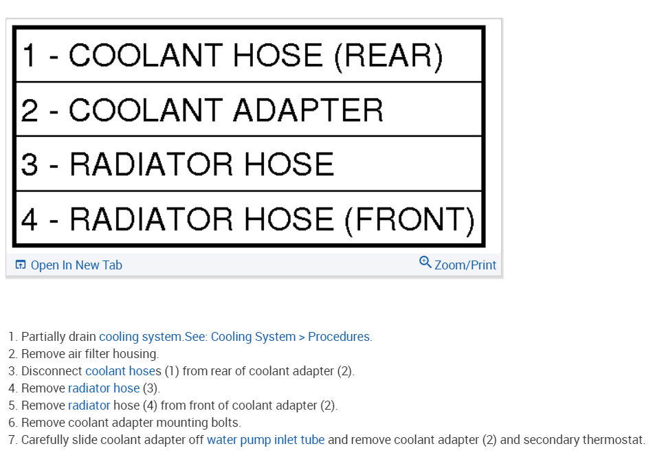

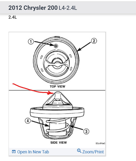

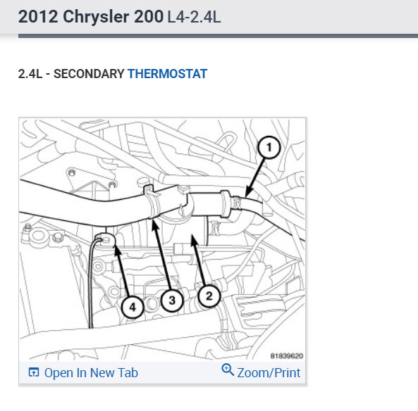

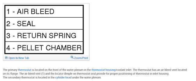

So, the cooling thermostat only goes in one way and if it is backwards then the engine will overheat and boil. Also, if the cooling system is low on coolant the heater will not work, here is how the thermostat is replaced so you can double check your work and then once checked start the engine up and allow to warm up so the thermostat opens so you can fill the cooling system completely. Apparently, there are two thermostats please check the images below. The red arrow shows the part that should be sticking out. Also, this guide can help as well:
Check out the images (below). Please let us know what you find. We are interested to see what it is.
