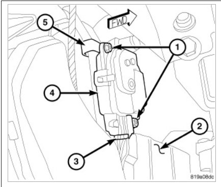

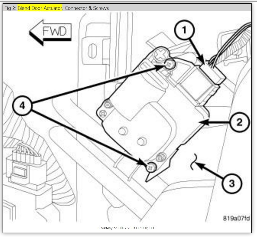

my 200 S is only getting heat on drivers side and cool air on passenger side. I replaced the blend door actuator behind the glove box. Still having the same issue.need help please.
Thanks brandon powell
Dec 1, 2016 at 9:03 AM
  • 55,433 POSTS
Hey Brandon,
This is a common problem, the driver side of the blend door actuators has gone out, here is a guide to walk you through the steps of replacing it and diagrams on which one to replace in your car int he diagrams bbelow.

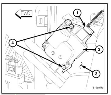

BRANDON261982
I dont see a diagram or a guide on my 2012 chrysler 200.
Dec 4, 2016 at 7:16 AM
  • 55,433 POSTS

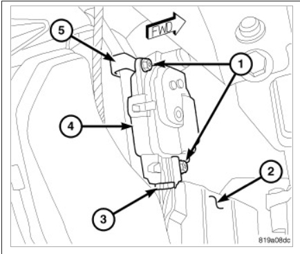

Here is the only image Mitchell1 gives us, once you have it removed turn the heater on and work the blend door by hand to see what it does to make sure you have the right one

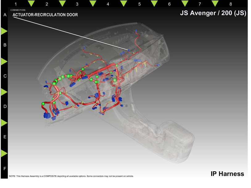

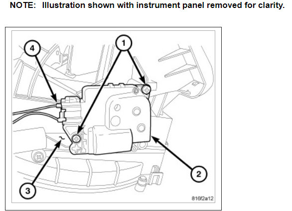

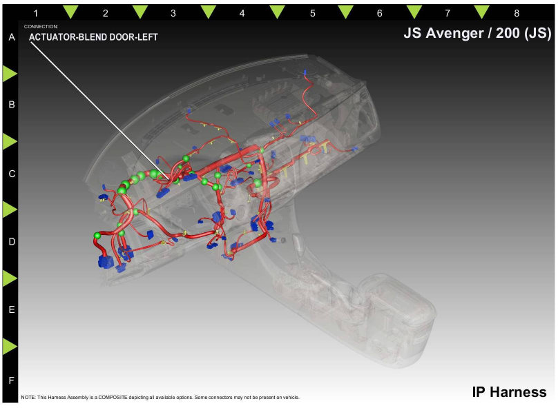

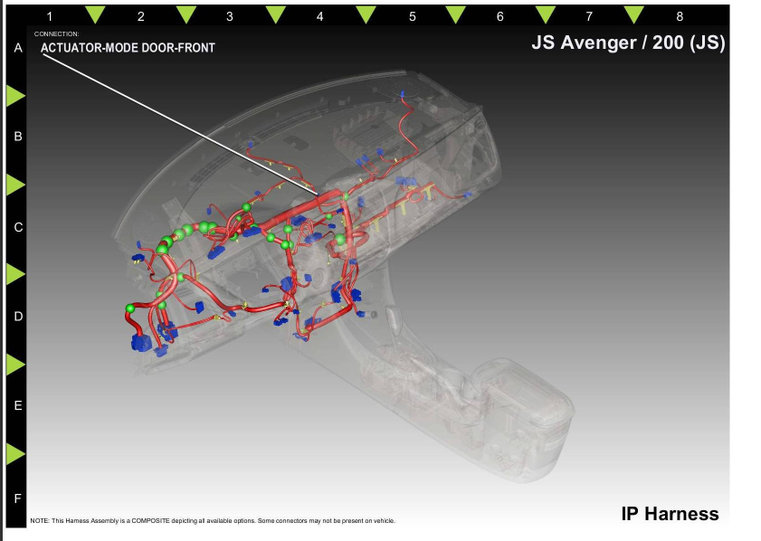

FRED REEVE
Admin, where exactly is that picture? Behind glove box? Or behind radio, temp control panel?
Dec 29, 2017 at 10:56 PM
  • 55,433 POSTS
Here are more diagrams to help you see where the locations of the blend door actuators are located. Check out the diagrams (Below)
Jan 1, 2018 at 5:59 AM
FRED REEVE
Thank you the guides and instructions were great I love this site.
