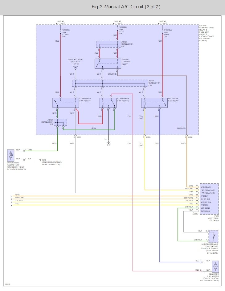

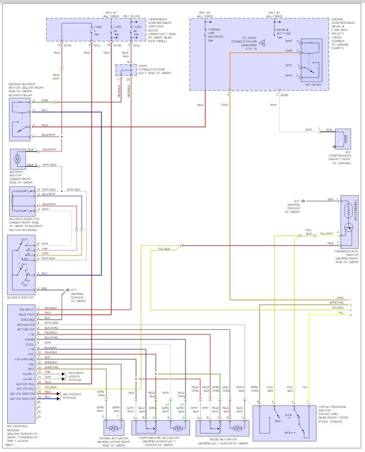

Hello, my climate control stopped working at the same time as my sunroof. The climate control is not getting power as the rear defog light or the in cabin circulation botton light does not come on. I check every fuse and it seems everything is getting power.

That car has several fuse panels, did you check the one in the passenger compartment and the one under the hood, left front corner?

Sorry I didn't reply sooner. I can't seem to find any other fuse panels, I checked all the spots and there's only 2..... In font of the driver under the steering wheel to the left and under the hood in front of th driver as well

I looked behind the glove box and behind the 2 panels on the driver and passenger side that you can only get at when the doors are open

It looks like there are some fusible links that would effect these systems as well, here are some diagrams for you, please let me know what you find

Here they are
