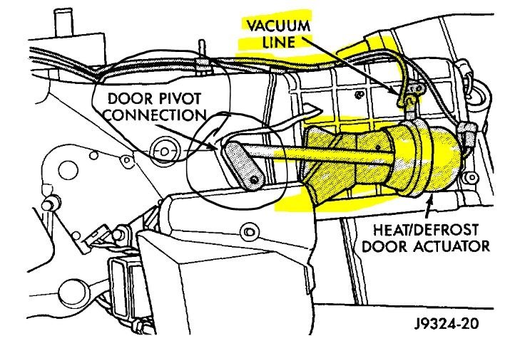

My diverter is stuck in the defrost position. I saw your answer about the vacuum lines and did not anything obvious. I did notice that the aluminum tubing line running over the radiator overflow tank has a female threaded plug. That plug is missing. Could that be the problem or can that cap/plug be another problem that I'm not aware of yet? Thanks, Rich

Rich, if it is an aluminum line, that most likely isn't a vacuum line. If you upload a pic of it, I can confirm it for you.
Now, we have a couple different links related to vacuum issues. Is this the one you checked?
https://www.2carpros.com/articles/air-vents-stay-in-the-defrost-position
Now, if there are no leaks, then we have to suspect what is called a Mode Door actuator has failed or isn't receiving vacuum to change air flow direction. I am going to provide the directions for the mode door actuator replacement. Rather than just replacing the part, I recommend checking to see if there is vacuum going to it. At the bottom, I will attach pictures of the component that correlate with the directions. They will indicate where the vacuum supply is located (hose). Simply check if you can feel a vacuum to that hose when trying to change the air flow direction. Note that the engine must be running when you to it.
If there is vacuum, then follow the directions for replacement. If there isn't, then you will need to trace the vacuum hose back to the controller to see if you can find a leak there or you can remove the supply line direct from the engine to see if there is vacuum there.

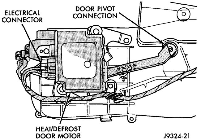

Now, there could be two different designs used on this vehicle. If you have automatic temperature control, the mode door actuator will be electric. That is the first picture below. If it isn't automatic, then it will be vacuum.

Heat/Defrost - Panel/Defrost Door Motor
This motor is used only on models equipped with the optional Automatic Temperature Control (ATC) system.
1. Disconnect and isolate the battery negative cable.
2. Remove the two bolts that secure the center instrument panel support bracket to the left side of the floor panel transmission tunnel.
3. Remove the two bolts that secure the center instrument panel support bracket to the instrument panel.
4. Remove the center instrument panel support bracket from the vehicle.
Heat/Defrost - Panel/Defrost Door Motor Remove/Install
pic 1
5. Unplug the wire harness connector from the heat/defrost - panel/defrost door motor.
6. Remove the three screws that secure the heat / defrost - panel/defrost door motor to the bottom of the heater-A/C housing.
7. Remove the heat/defrost - panel/defrost door motor from the heater-A/C housing.
8. Reverse the removal procedures to install. Tighten the mounting screws to 2.2 N.m (20 in. lbs.).

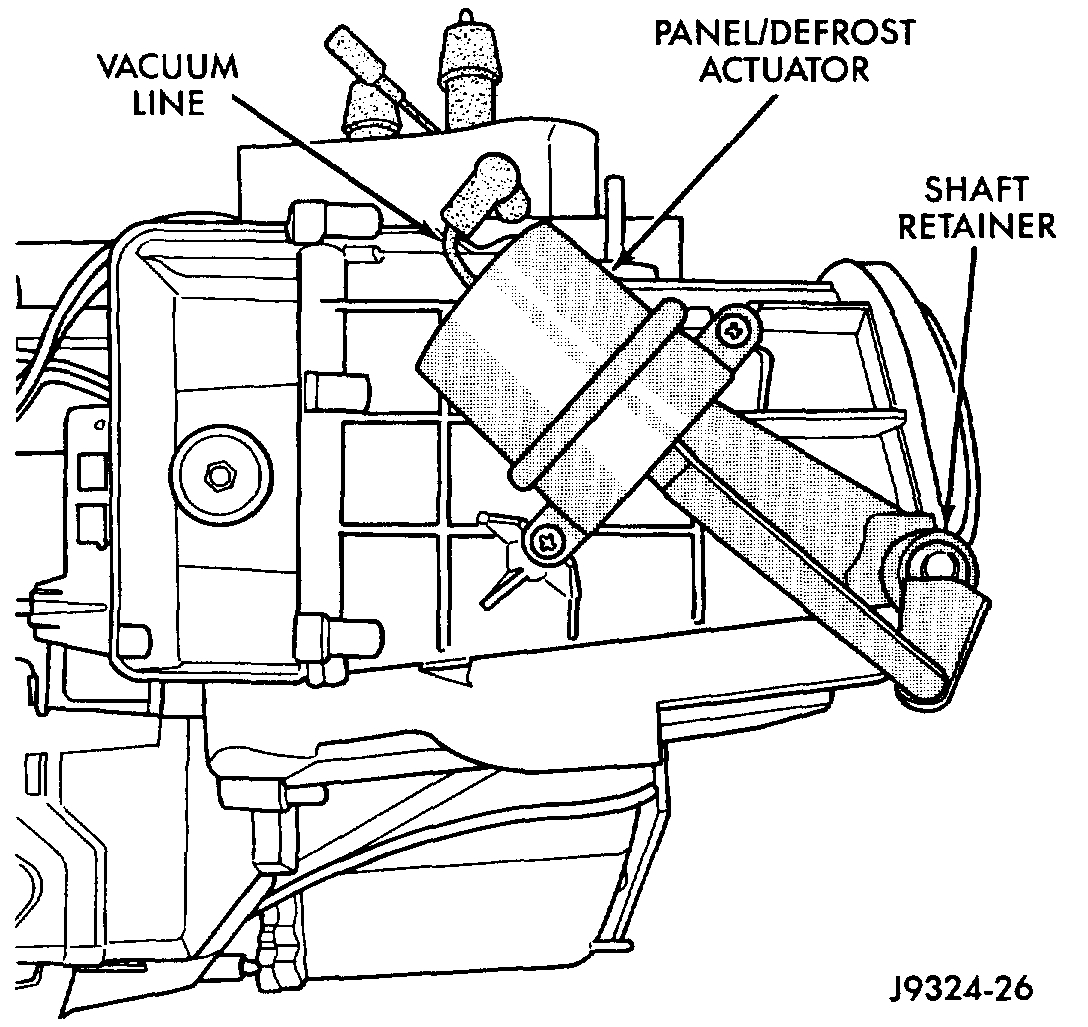

Panel/Defrost Door Vacuum Actuator
This actuator is used only on models equipped with the standard manual temperature control system.
1. Remove the heater-A/C housing from the vehicle. See Heater-A/C Housing for the procedures.
Panel/Defrost Door Vacuum Actuator Remove/Install
pic 3
2. Unplug the vacuum harness connector from the heat/defrost door vacuum actuator.
3. Disengage the panel/defrost door pivot connection from the panel/defrost door pivot pin.
4. Remove the screws that secure the panel/defrost door vacuum actuator to the heater-A/C housing.
5. Remove the panel/defrost door vacuum actuator from the heater-A/C housing.
6. Reverse the removal procedures to install. Tighten the mounting screws to 2.2 N.m (20 in. lbs.).

Note in pic 2 I highlighted the component in question and circled the linkage. Make sure the linkage didn't come disconnected.
