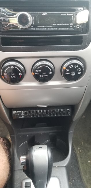

Can you take a picture of your climate controls so I can see them? If it is just one side not working it is either a blend door actuator or inside the heater plenum a door has broken which means the plenum will need to be replaced. You can upload the picture in your response.

This is the climate control.
Jun 24, 2019 at 8:17 AM
  • 55,847 POSTS
Yep, signal control. It looks like you have a broken blend door. you will need to remove the heater plenum. here are instructions and diagrams to help you get the job done. Start by draining the coolant and disconnecting the battery. Also you will need to discharge the AC system. here are guides to help check out the diagrams below.
