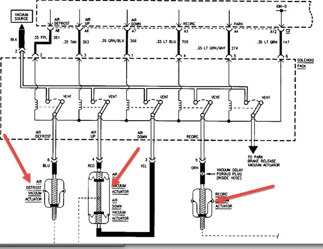

I have no air pushing from my front vents, nothing from defroster or floor blowers either. The rear/center console blows air though.

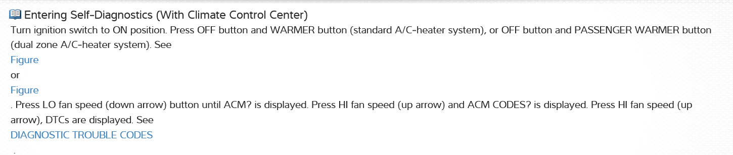

do what it says in picture to pull any codes from heater as it is the automatic temperature control. then get back with a code as it can be an actuator problem, broken door, etc.

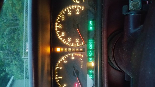

CODY NEUMAN
  • 6 POSTS
This is what I got
Jul 5, 2016 at 5:39 PM
CODY NEUMAN
  • 6 POSTS
No codes

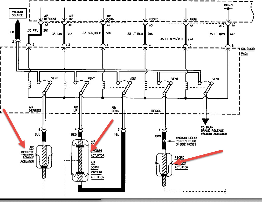

check for a vacuum leak it can leak from engine or control head as well as no vacuum going to motors in pic
