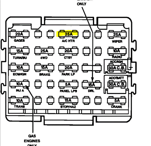

Have no lights on the climate control panel and it's not working no fan or heat or A/C.

If nothing is working, first I need you to check the fuse for the circuit. The fuse box should be on the driver's side under the instrument panel. In addition to checking the fuse's condition, it is important to make sure there is power both to the fuse and out from it.
Let me know what you find.
See pic below.

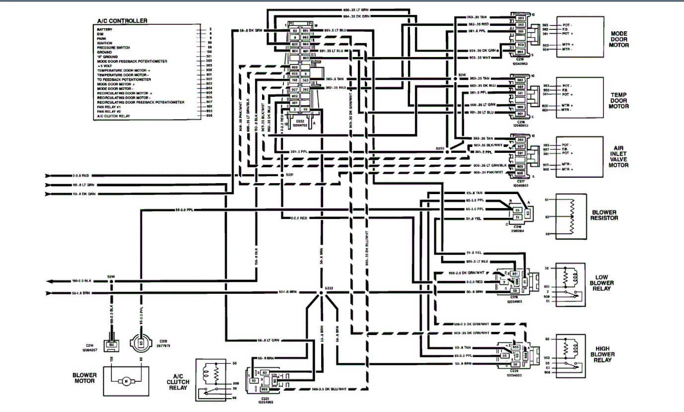

All of those fuses are good. So, i'm guessing it's more than likely a wiring issue but we can't find a diagram for it.

Do me a favor. I was able to dig up older factory wiring schematics related to the circuit. Take a look through them and let me know if they help. Also, here is a link you may find helpful:
