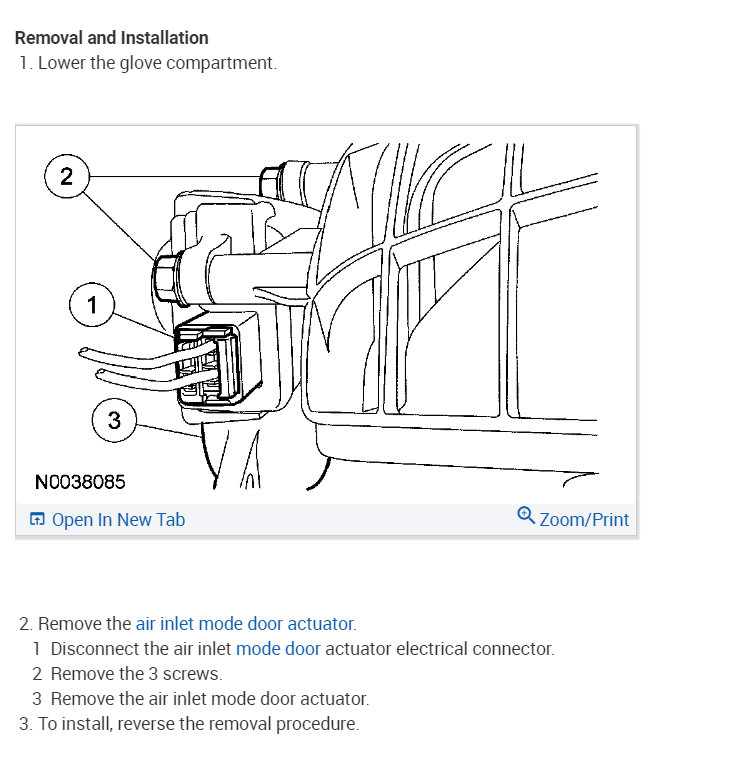

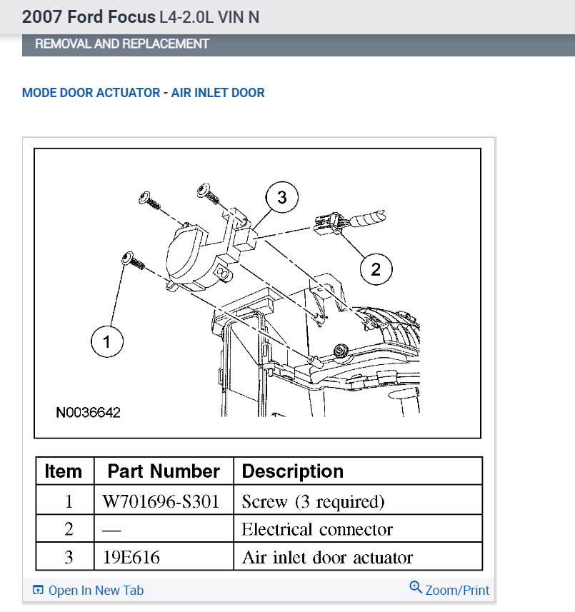

Air is blowing through all the vent on my car?
2007 FORD FOCUS
219,000 MILES • 2.0L • 4 CYL • 2WD • AUTOMATIC
DEVIN320
MEMBER
2 POSTS
Aug 30, 2022 at 10:10 AM
Experienced Mechanic
55,549 POSTS
I have seen this problem before, and the mode actuator replacement fixed the problem here is how to do the job in the diagrams below. Let me know how it goes and upload pictures of the problem if you can.
