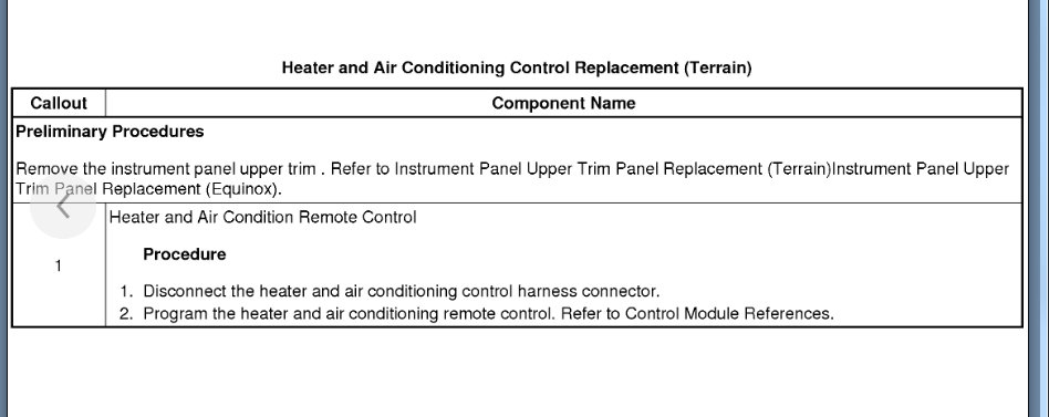

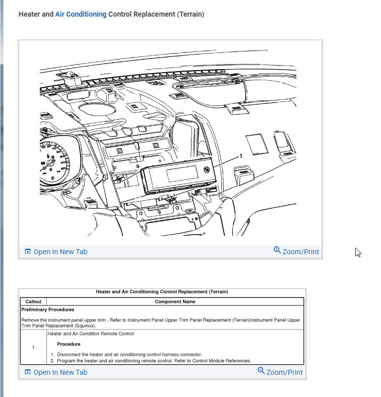

So I got the part today and installed it .so yes it seems it is now working at auto came on and started blowing cold air. now my question is, is do I need to have it programmed at the dealership it doesn't seem to be working properly when I use the fan control it now changes the temperature and the temperature control does nothing and only the defrost button works . It seems it just needs to be programmed . Is it a bad part or does it need programming ?
Jun 1, 2020 at 7:48 AM
There is a programming step at the end of the install process but I don't think it will solve this issue.
However, it is worth a try to have it programmed if this was a new part. If you got it used then I suspect the part is faulty.

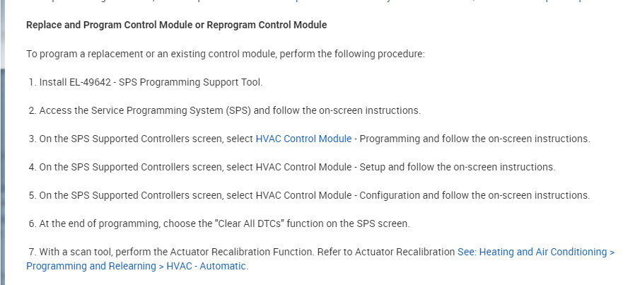

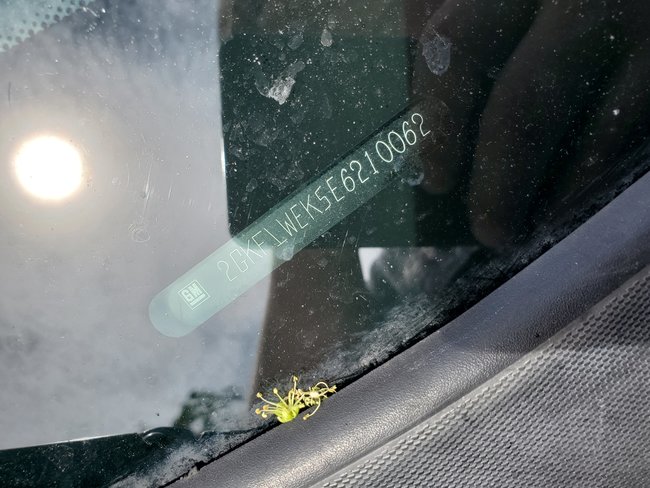

So I have a question, is there any way for me to program this myself using computer via USB port by downloading file? If so can you please walk me through it and give me software or files whatever it is I need to download? I will put my VIN up so the right software can be installed . I'd rather not pay $160.00 to have it programmed, but I will if I have to.
Jun 4, 2020 at 5:33 AM
Unfortunately it is not that type of "programming." You are not performing a software download type of programming. You are teaching the module the starting and stopping point of the doors in the HVAC system and calibrating the module to the sensors.
Basically each system will operate a little different so the module needs to learn the quirks of this one so that it can operate as best as possible.
This is why I doubt doing this process will fix what you are seeing with this module. Again, I would suggest just calling the supplier of the part and telling them what it is doing. I suspect they will just have you send that one back and they will send another.
