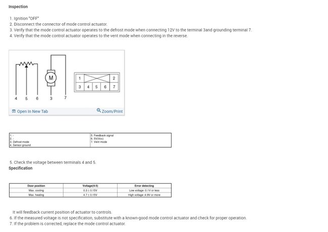

can't get defroster mode to work?
Dec 23, 2021 at 4:19 PM
Good morning,

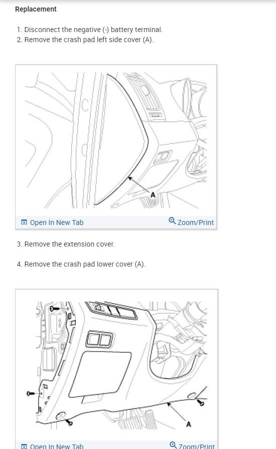

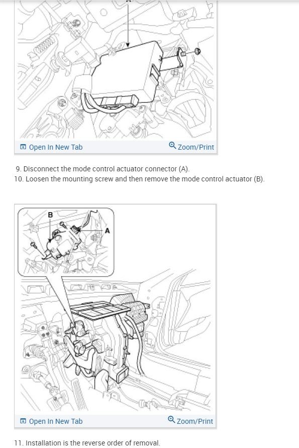

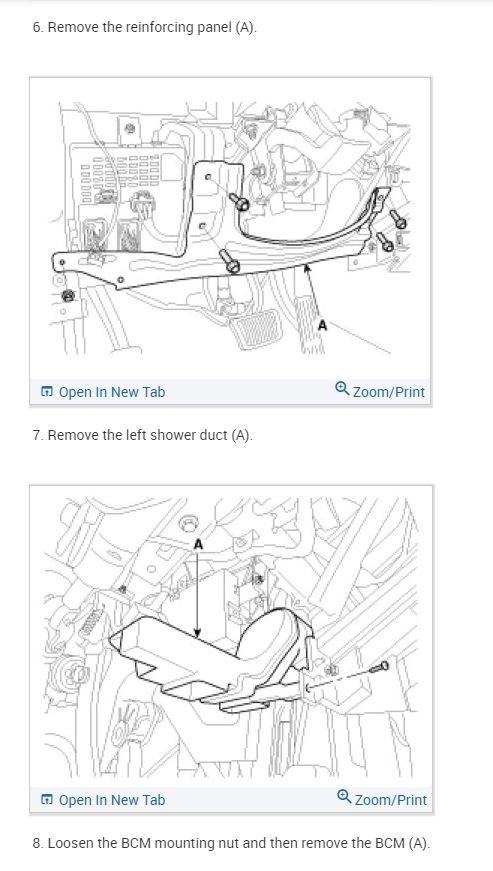

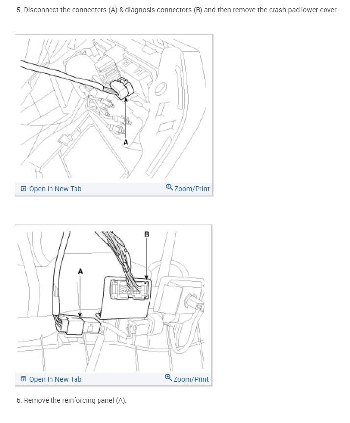

This sounds like the mode door actuator is the issue. It is difficult to access.
https://www.2carpros.com/articles/air-vents-stay-in-the-defrost-position
I attached the procedure for you below with pictures.
