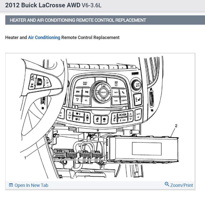

The fan is on, and it blows air, but I can't adjust the temperature, fan speed, A/C on or off or location i.e. feet, face, defrost. I've checked the fuse and it's good.
May 1, 2022 at 11:55 PM
  • 55,412 POSTS

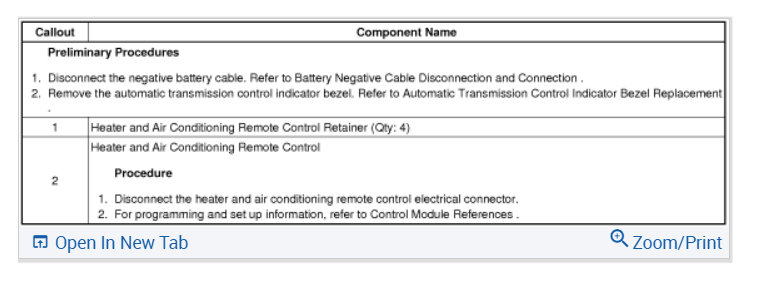

This happens when the HVAC control head goes out, but to be sure we can do a simple CAN scan by checking out this guide and watching the video. If confirmed here are instructions on how to replace it in the diagrams below.
HVAC System Control Module Programming and Setup
The following service procedures require either a programming or a setup event performed for a complete repair.
HVAC Control Module Replacement
If the HVAC control module needs to be replaced, the following procedures must be performed:
1. Connect a scan tool to the vehicle and access SPS. Refer to Service Programming System (SPS) See: Vehicle > Programming and Relearning > Service Programming System (SPS).
2. Perform the SPS function Remote Heater and Air Conditioning Control Module Programming and follow the on-screen instructions.
3. Perform the SPS function Remote Heater and Air Conditioning Control Module Configuration & Setup and follow the on-screen instructions.
4. Clear DTCs after completing the programming procedure.
