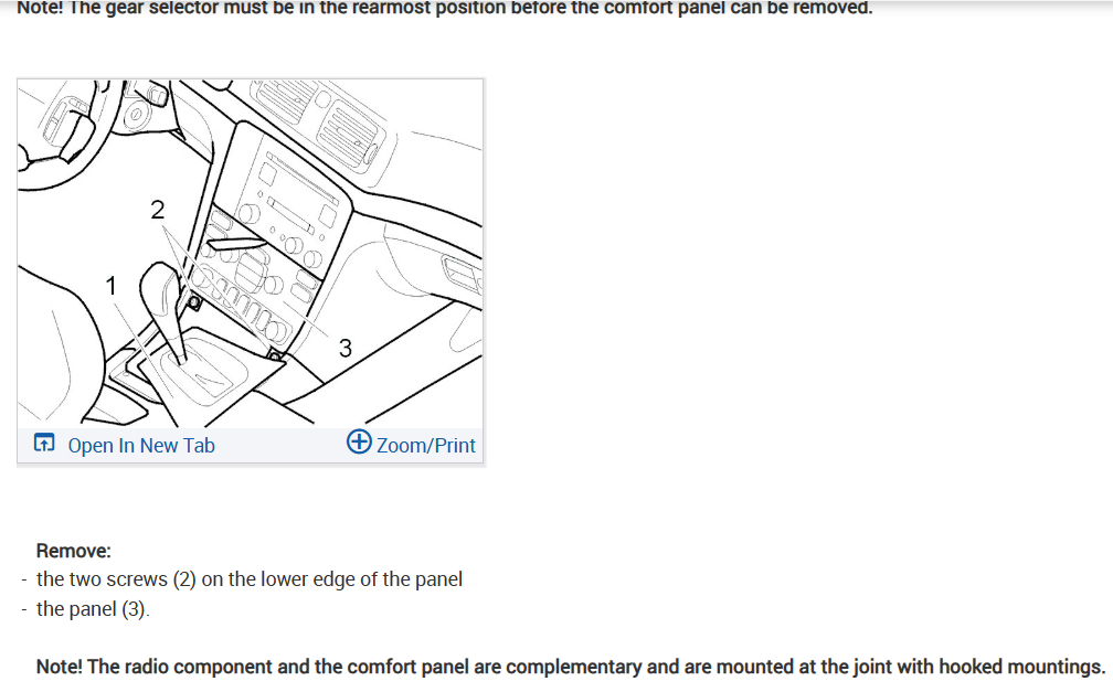

Many thanks for this information have tried all options with no luck all fuses checked but now suspect it can only be the climate control unit that has blown because unit dead no lights etc. Would you think the same?
Thanks again
Debbie
Apr 26, 2025 at 2:30 AM
  • 55,402 POSTS

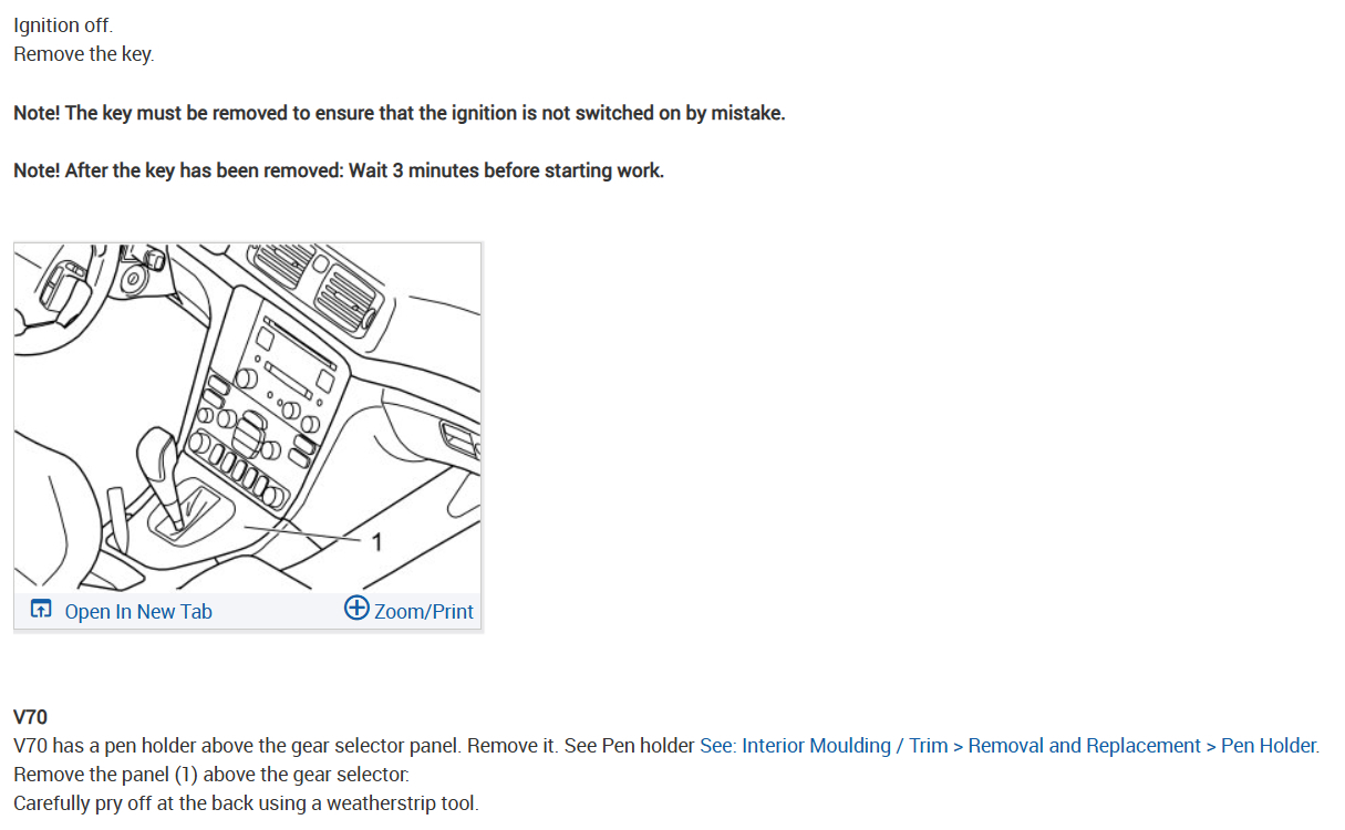

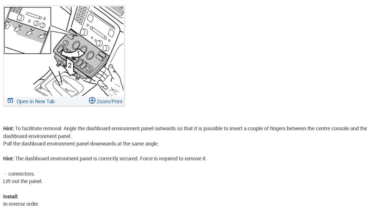

This can happen due to a voltage surge which can occur when the new battery was installed. Here is how to change the unit out, I would check eBay for a replacement part. Check out the images (below). Let us know how it goes.
