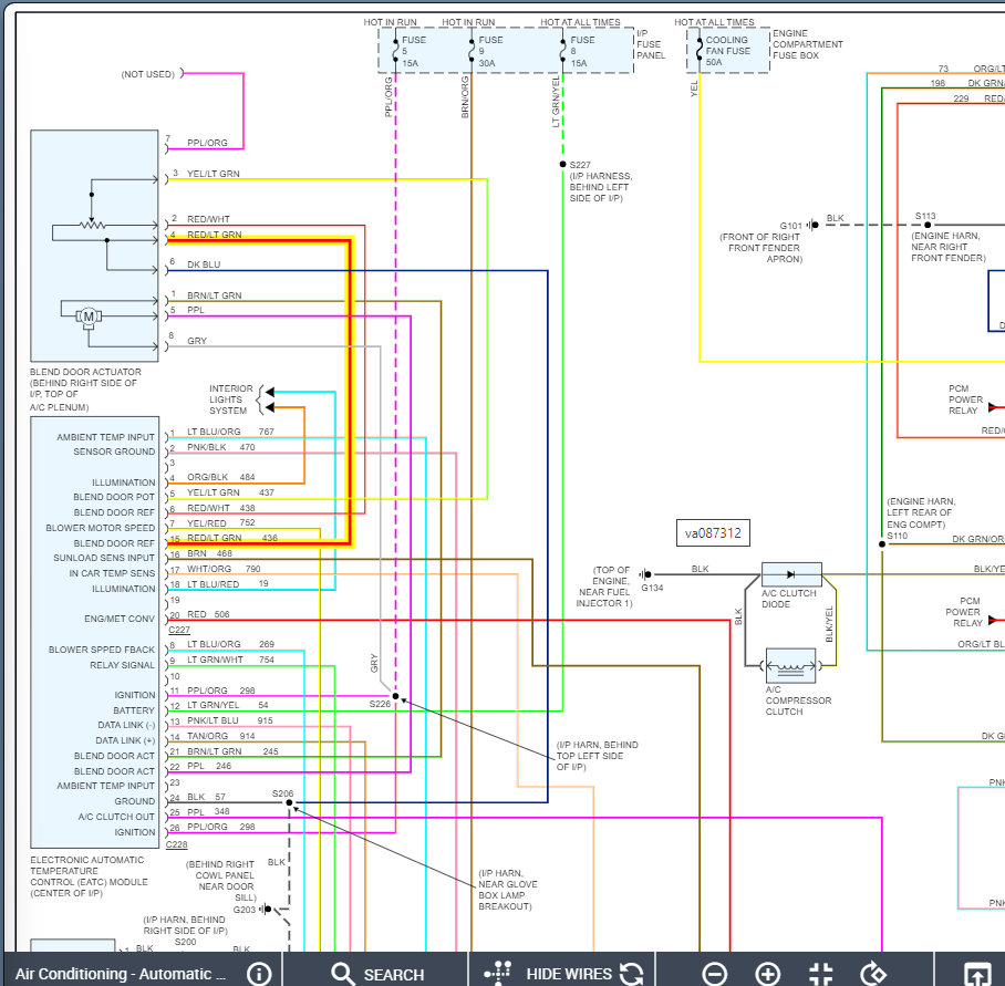

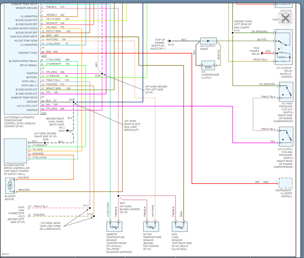

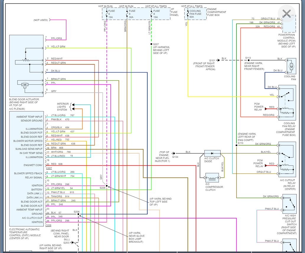

There are 2 plugs in the back of the climate control module, can you provide the pin outs for both?

No problem. I am attaching the complete wiring diagram below for your review.

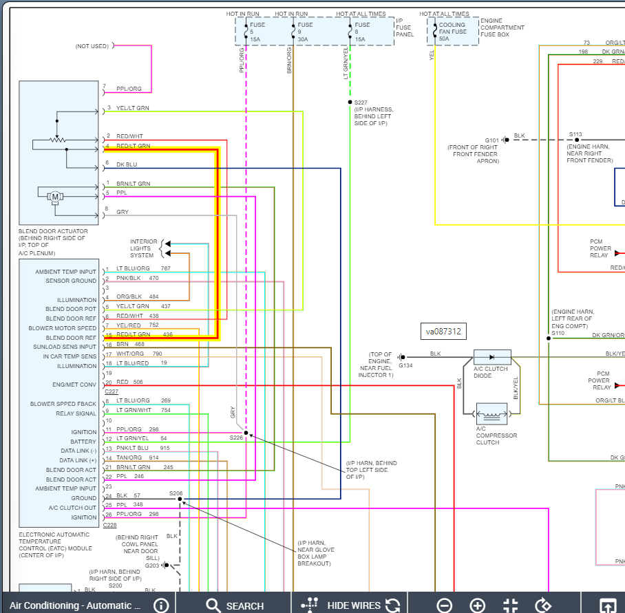

When plug 227 was plugged in I got no display, I cut line 15, blend door reference ccw and was able to get the display back and fan control.
What function did I lose?
Mar 24, 2022 at 10:21 AM
Okay. If this circuit is removed, then you have a short in the wire or the blend door actuator has shorted, and it is corrupting the climate control display.
So, I would suggest replacing the actuator if nothing else is found.
