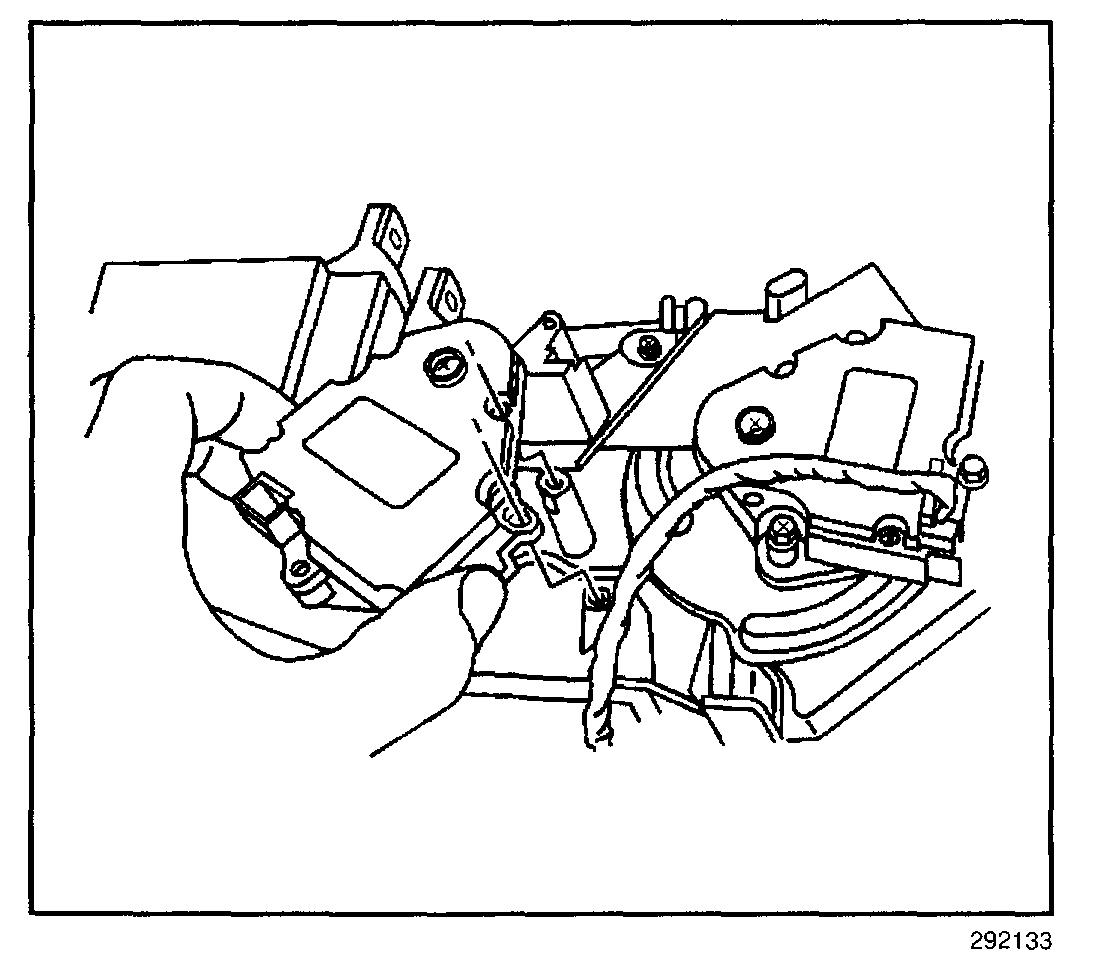

Blows cold air on driver side and warm air on passenger side with max temperature setting.
Dec 15, 2020 at 9:15 AM
  • 110,244 POSTS
This vehicle has two blend air door actuators. These are what determine what temp the air is when it enters the vehicle. Since you have cold air on the left side (driver's side), chances are the blend air door is bad which controls that side. What I would suggest is to simply remove it and check it for movement when you change the air temp request. If it doesn't move or you notice a clicking sound, replace the actuator.

pic 1
1. Remove the left side sound insulator. Refer to Closeout/Insulator Panel Replacement - Left in Instrument Panel, Gauges and Warning Indicators.
2. Remove the aspirator muffler.
3. Remove the electrical connector from the left air temperature actuator.
4. Remove the left air temperature actuator retaining screws (1).

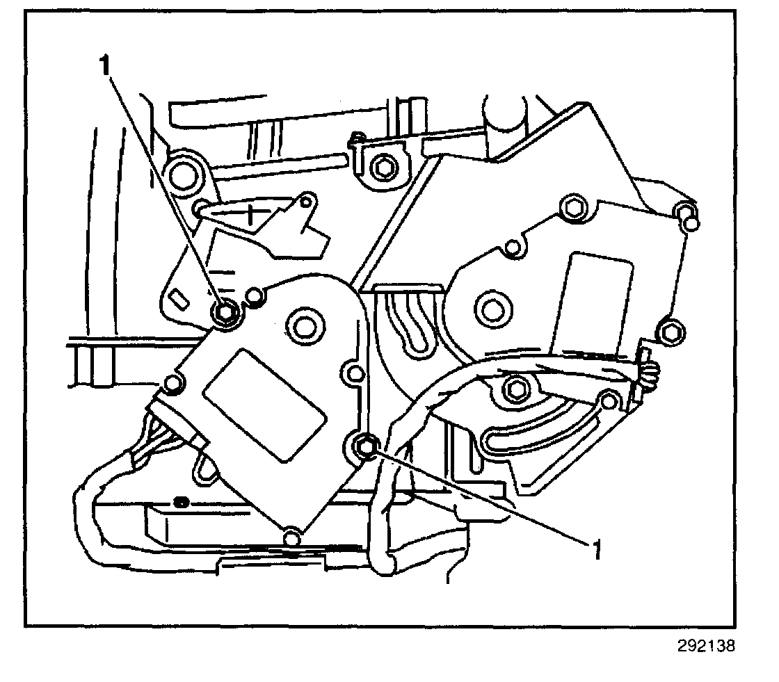

pic 2
5. Remove the left air temperature actuator.

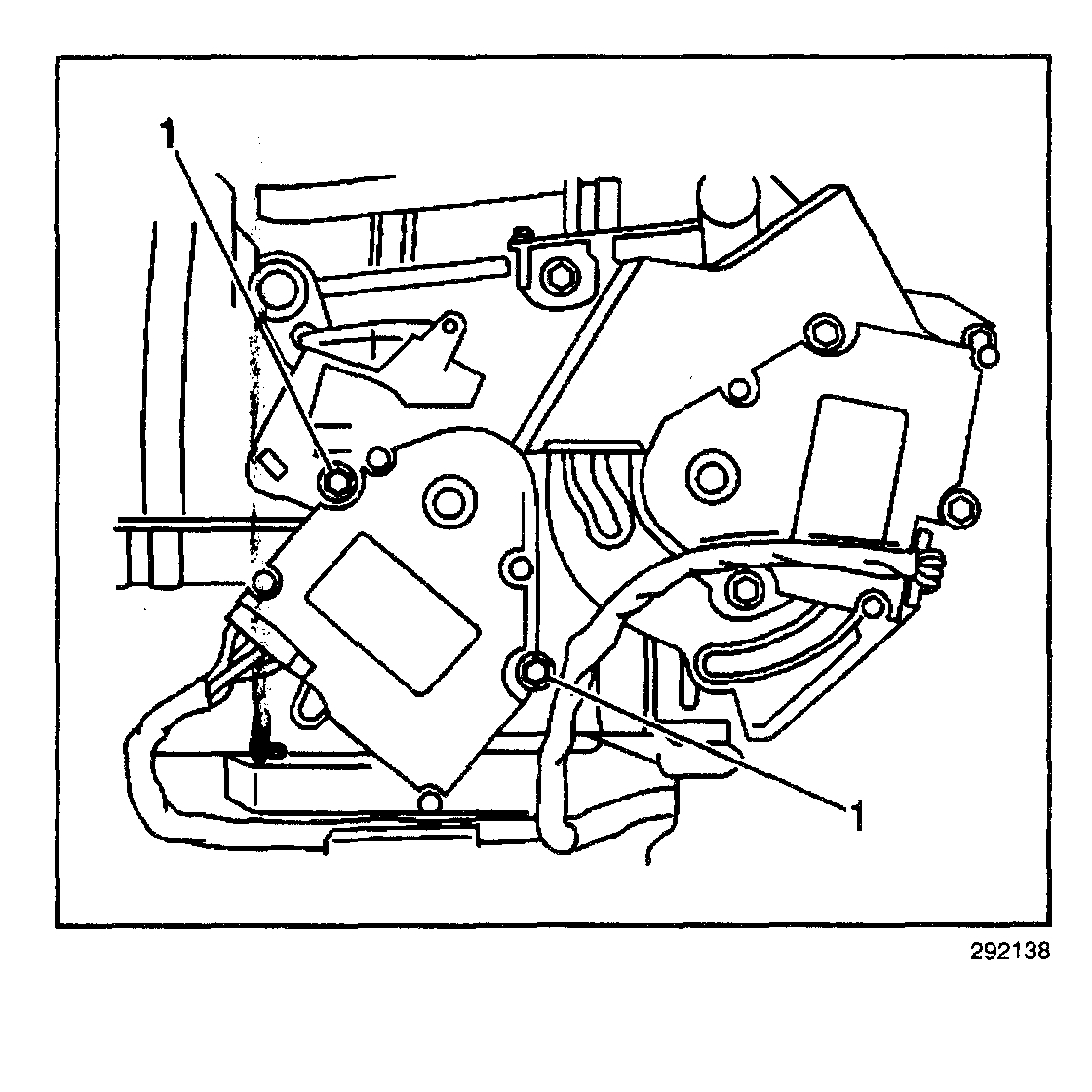

pic 3
1. Install the left air temperature actuator.
NOTE: Refer to Fastener Notice in Service Precautions.
pic 4
2. Install the left air temperature actuator retaining screws (1).
Tighten
Tighten the screws to 1.4 N.m (12 lb in).
3. Install the electrical connector to the left air temperature actuator.
4. Install the aspirator muffler.
5. Install the left side sound insulator. Refer to Closeout/Insulator Panel Replacement - Left in Instrument Panel, Gauges and Warning Indicators.
6. Recalibrate the actuators. Refer to Re-Calibrating Actuators.
