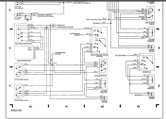

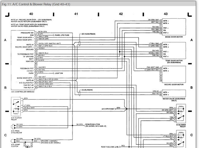

The digital climate control panel has started to sporadically cut on and off. This started very recently, so it has only happened a couple of times. The first time it happened, the display went blank, and the fan stopped blowing. It stayed off until I got to my destination. Once I got to my destination, I turned the truck off, and when I turned the key back to the "on" position, the display was on, and the fan was running. It worked fine for a couple of days, and then it happened again. It did almost the same thing as the first time, only when the display went blank, there were various icons on the display that would flash, like it was trying to turn back on and couldn't. The fan also stopped this time as well. Another thing that was different is that a few moments after it went out, the display came back on by itself, and the fan began working. I do not know if there is a fuse for the climate control, or perhaps a relay. Where do I start checking this? Or do you think the climate control panel itself is going bad? Thanks!

HMAC300
  • 48,601 POSTS

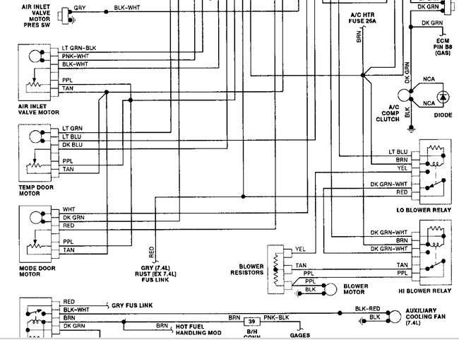

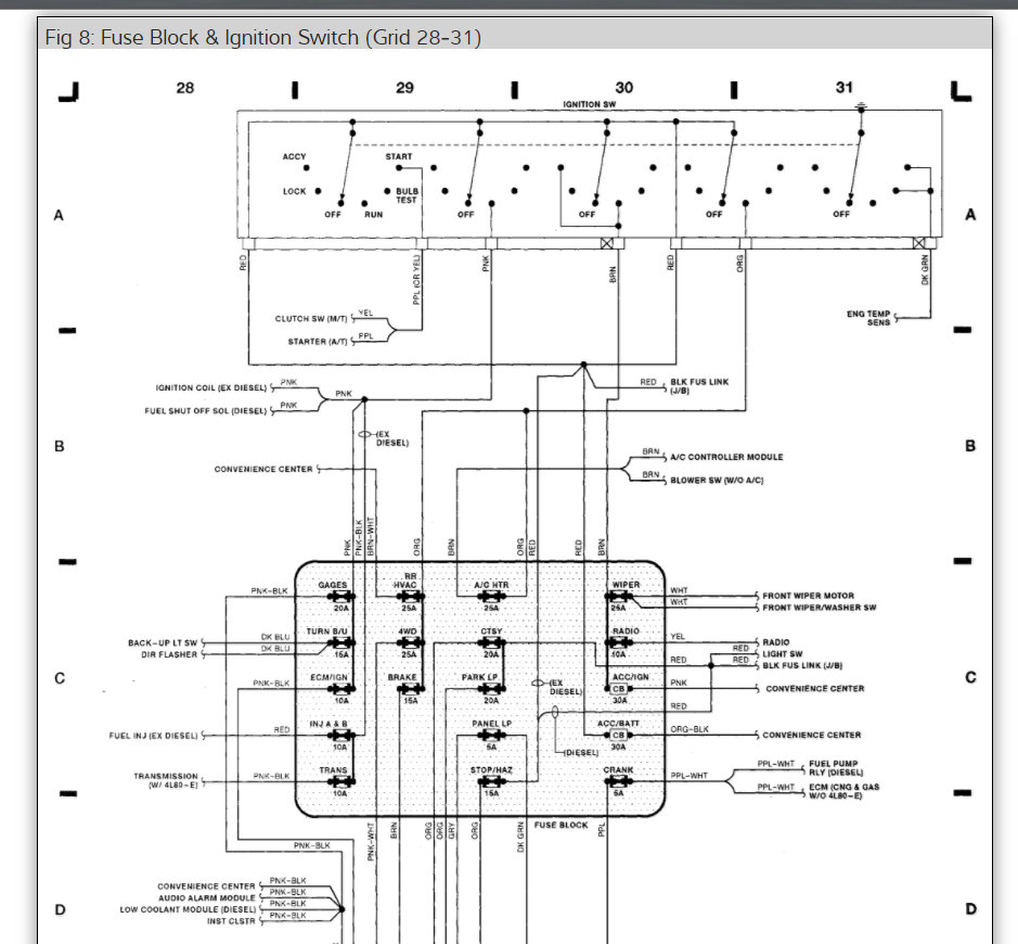

I looked up the harness for this and there are a few blower relays which I don't think are the problem. Because you say the panel doesn't light up kind makes me think the control is bad i'll send the harness diagram it cold be the relay but I kind of doubt it being electronic it's probably something is bad in the unit itself or the wires leading to it may be melted and not making contact due to age. See pics for schematic.
+5

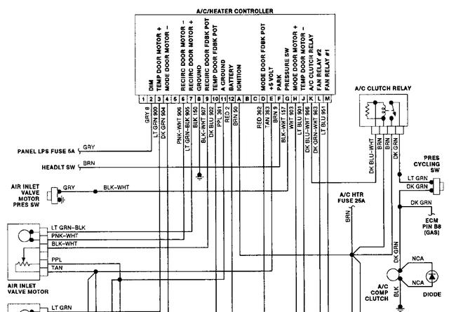

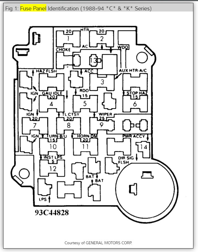

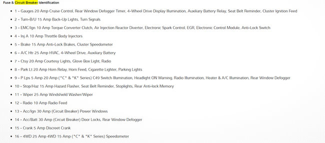

SERVICE WRITER
  • 9,123 POSTS

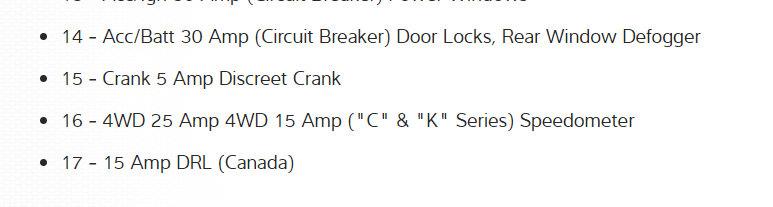

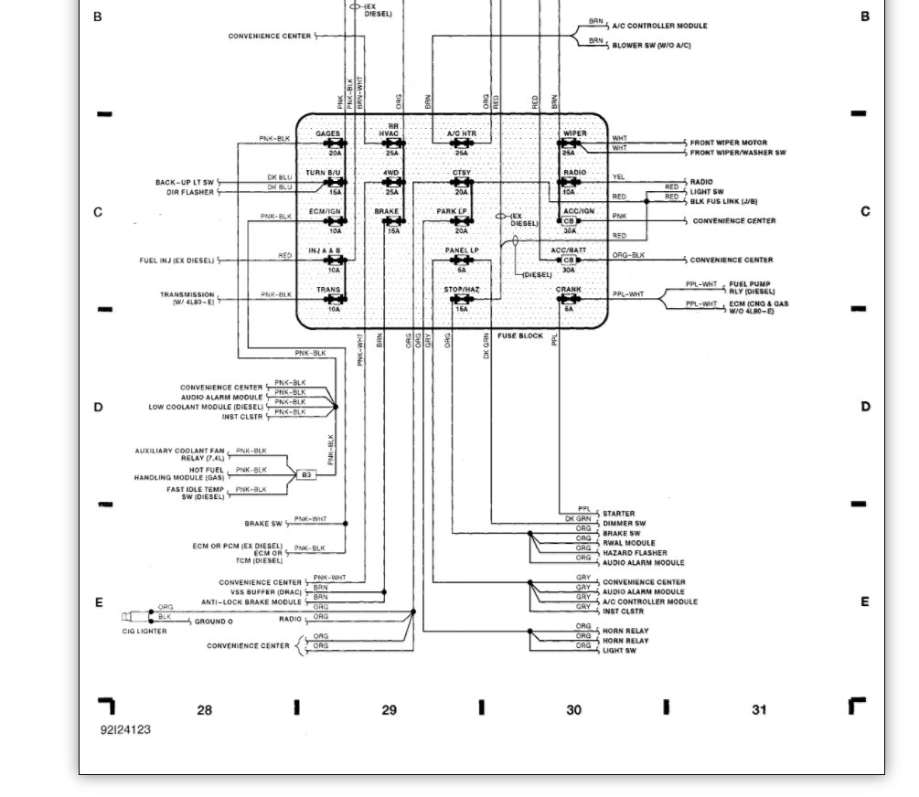

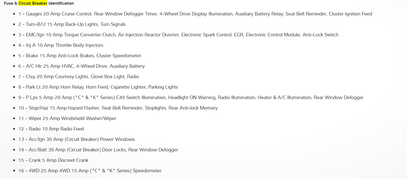

It sounds like the LPS fuse is out becasue that is what runs the system. Here is a guide and a wiring diagram so you can do some testing.
and
Check the power and ground to the controller also check the heater fuse while you are at it. Here is the fuse panel and air conditioner wiring diagrams (below)
Cheers
+7
Friday, April 30th, 2021 AT 4:14 PM (Merged)
HOGKING
O man you nailed it the LPS fuse was blown I had no idea I should be checking that fuse you guys are the best and I love 2CarPros!

CYNDA R

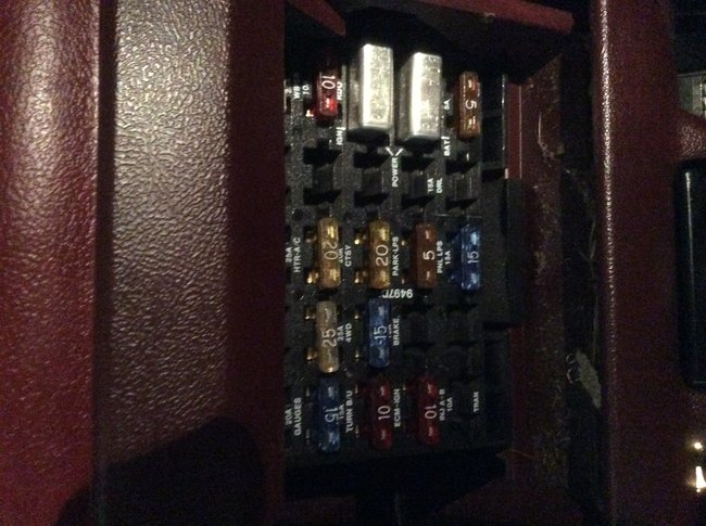

We checked all of the fuses and they look okay. We opened the hood and jiggled all of the wires while the key was on (not the engine) so we could see if it was in the wires by observing inside to see if the power to the control box flickered on and off at anytime. No luck. We cannot locate where our LPS fuse is located. Here is a picture of out fuse box.

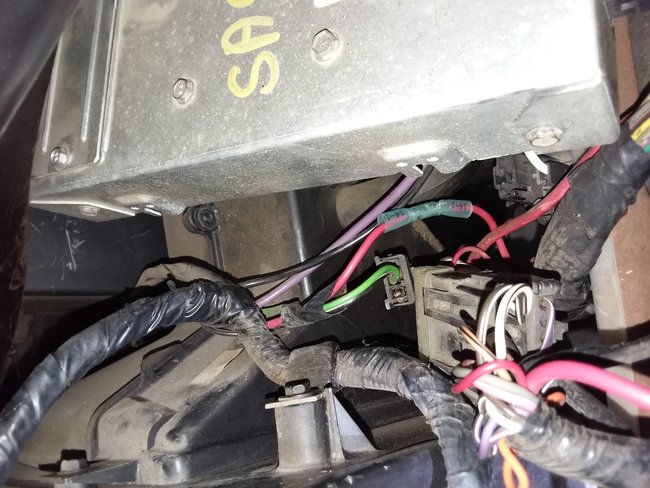

WISE MAN

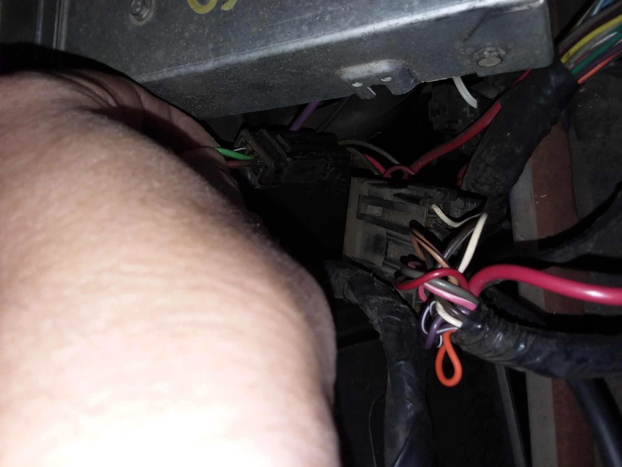

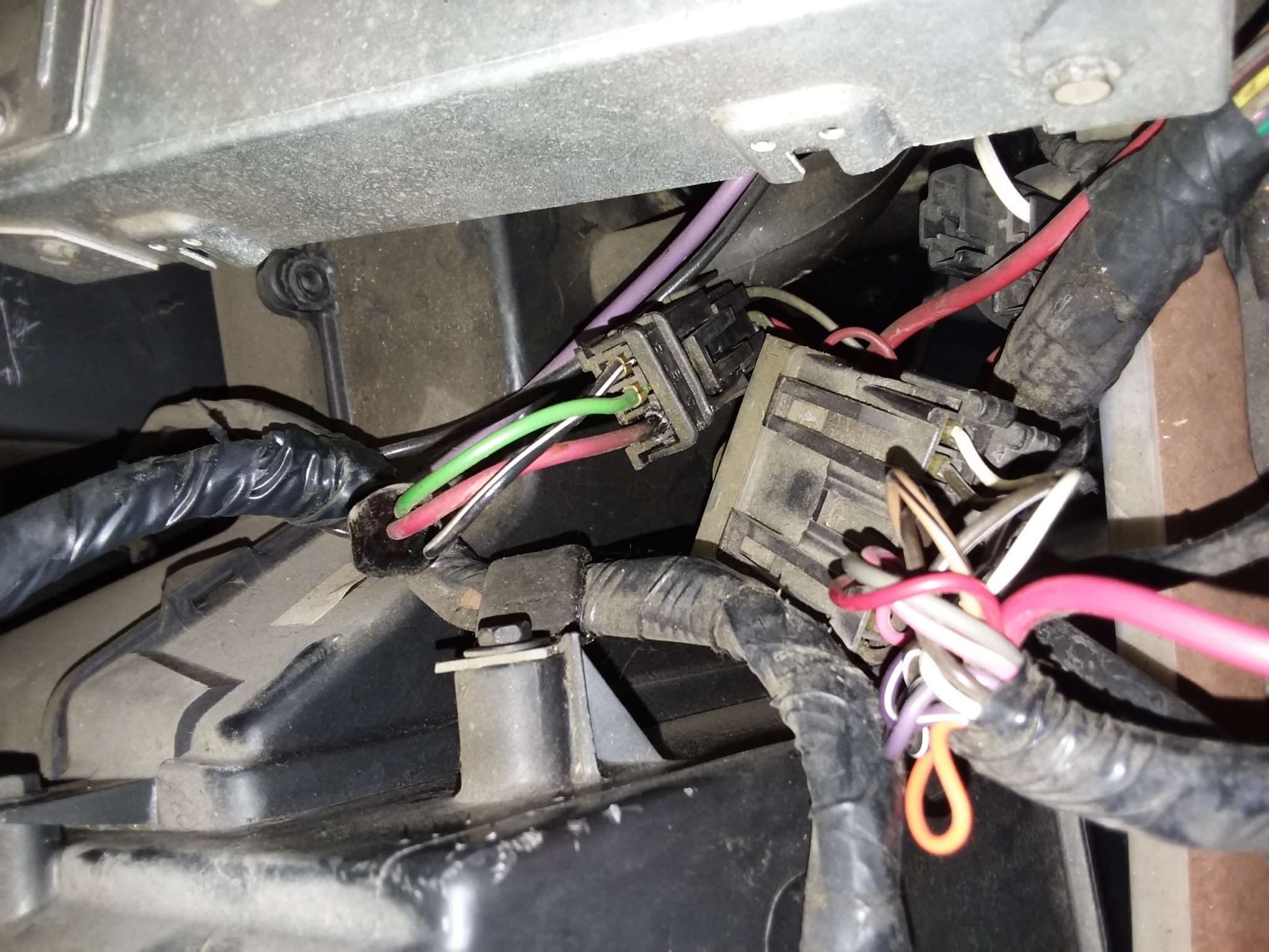

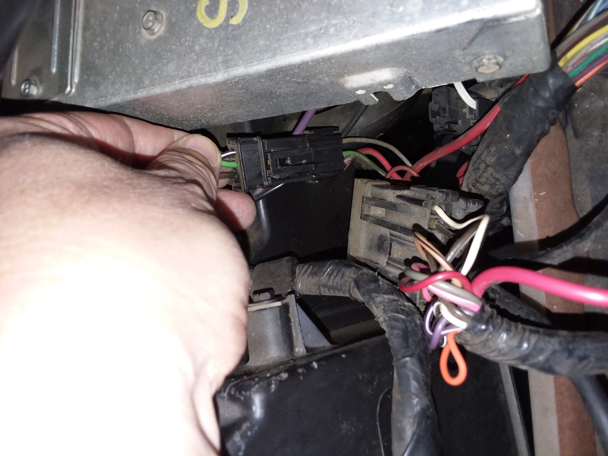

So this is what I found on my 1990 GMC. I have only found this 1 time on the internet. Remove glove box. Left of ecu. There is a 3 wire plug. On mine red green, black with a white tracer. The red wire was burnt and making poor contact and the plug was burnt. This also controls the radio circuit. If you move the wire harness under the dash you will see the dash control flicker or stay on. Any how repair the red wire and your issues should go away like mine did. I did not need a need dash control.
