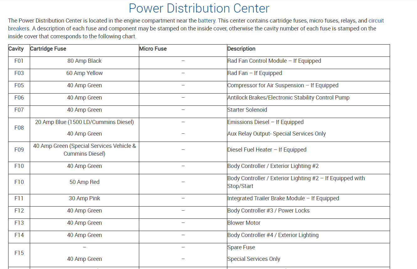

just curious to see why my blower motor stopped working

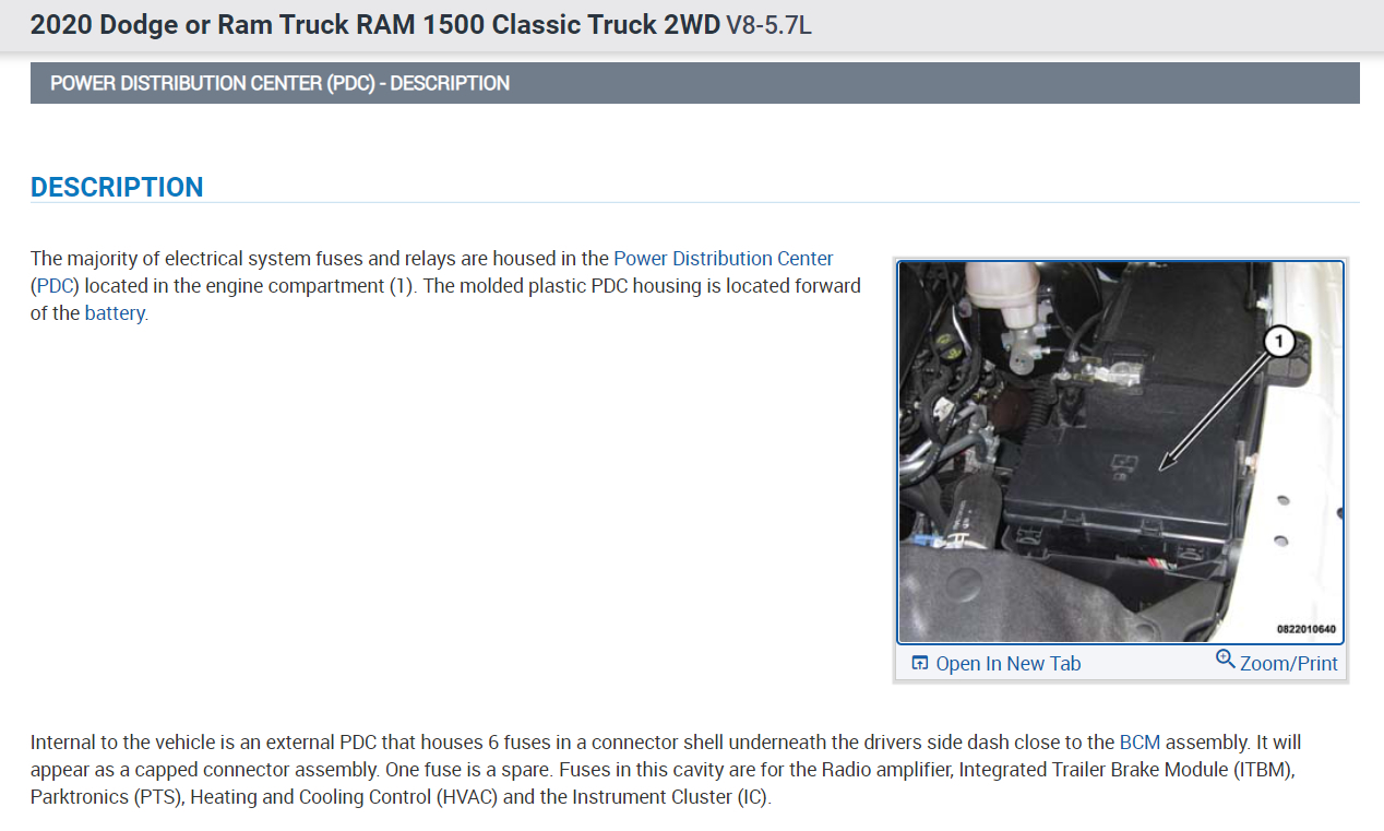

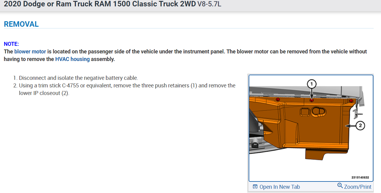

During the this crazy winter storm URI and was just curious to see why my blower motor stopped working can I fix it?

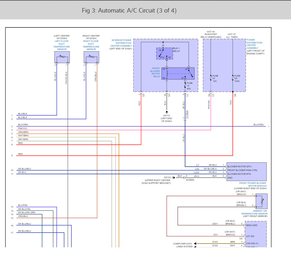

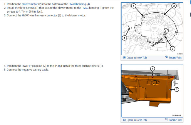

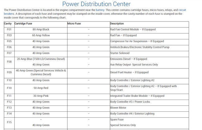

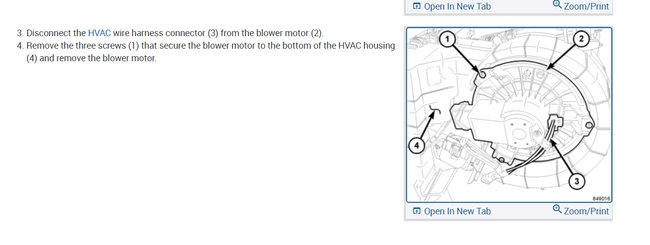

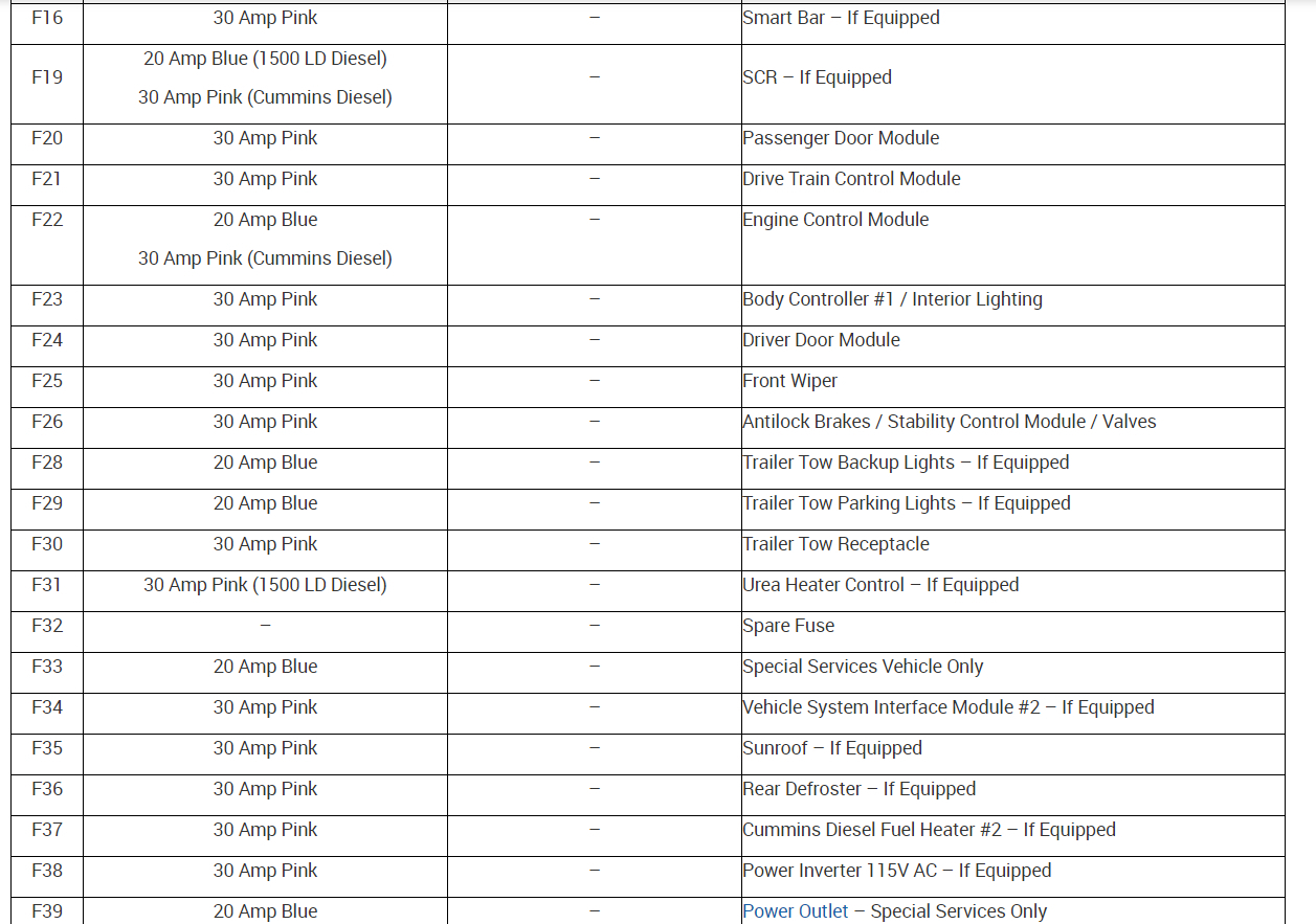

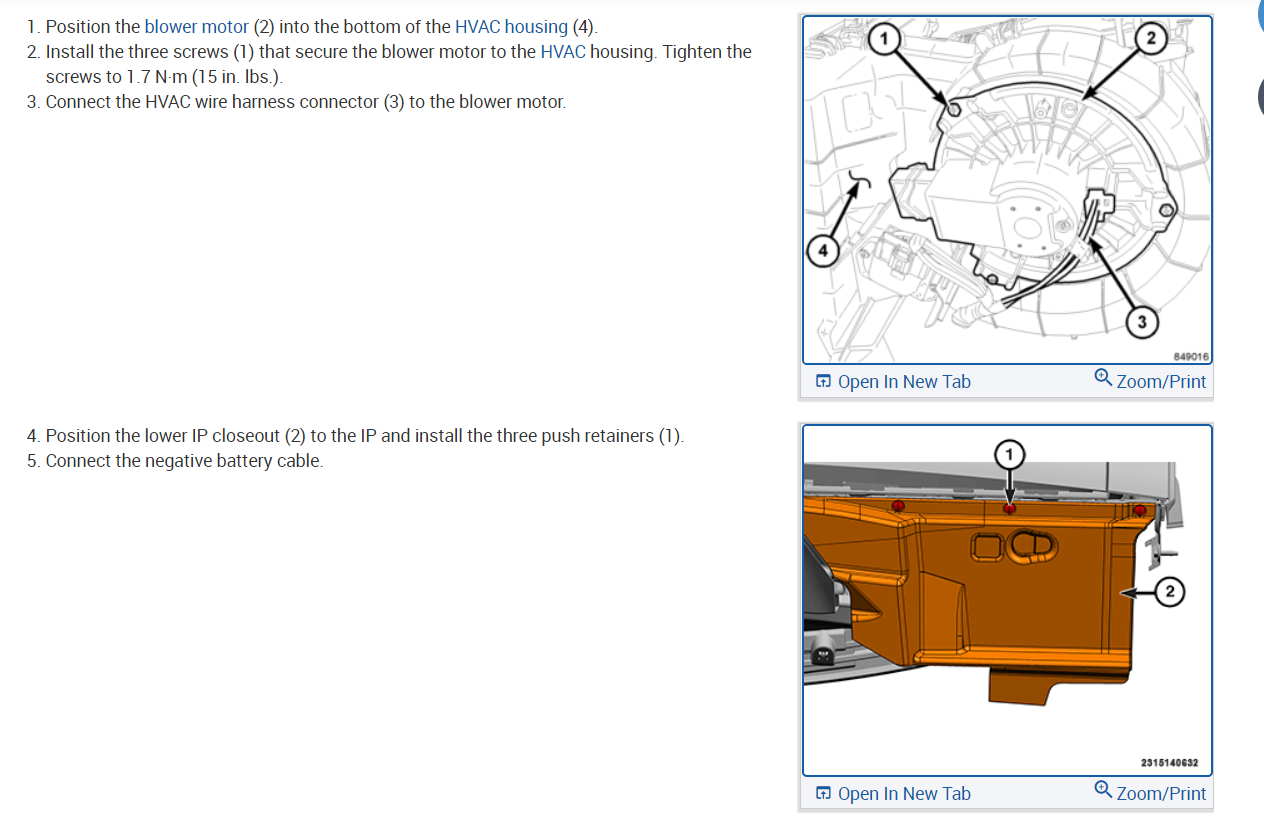

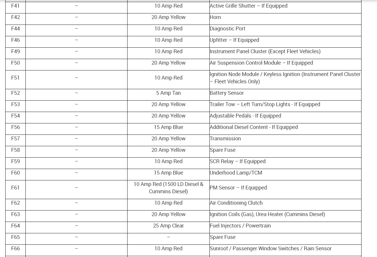

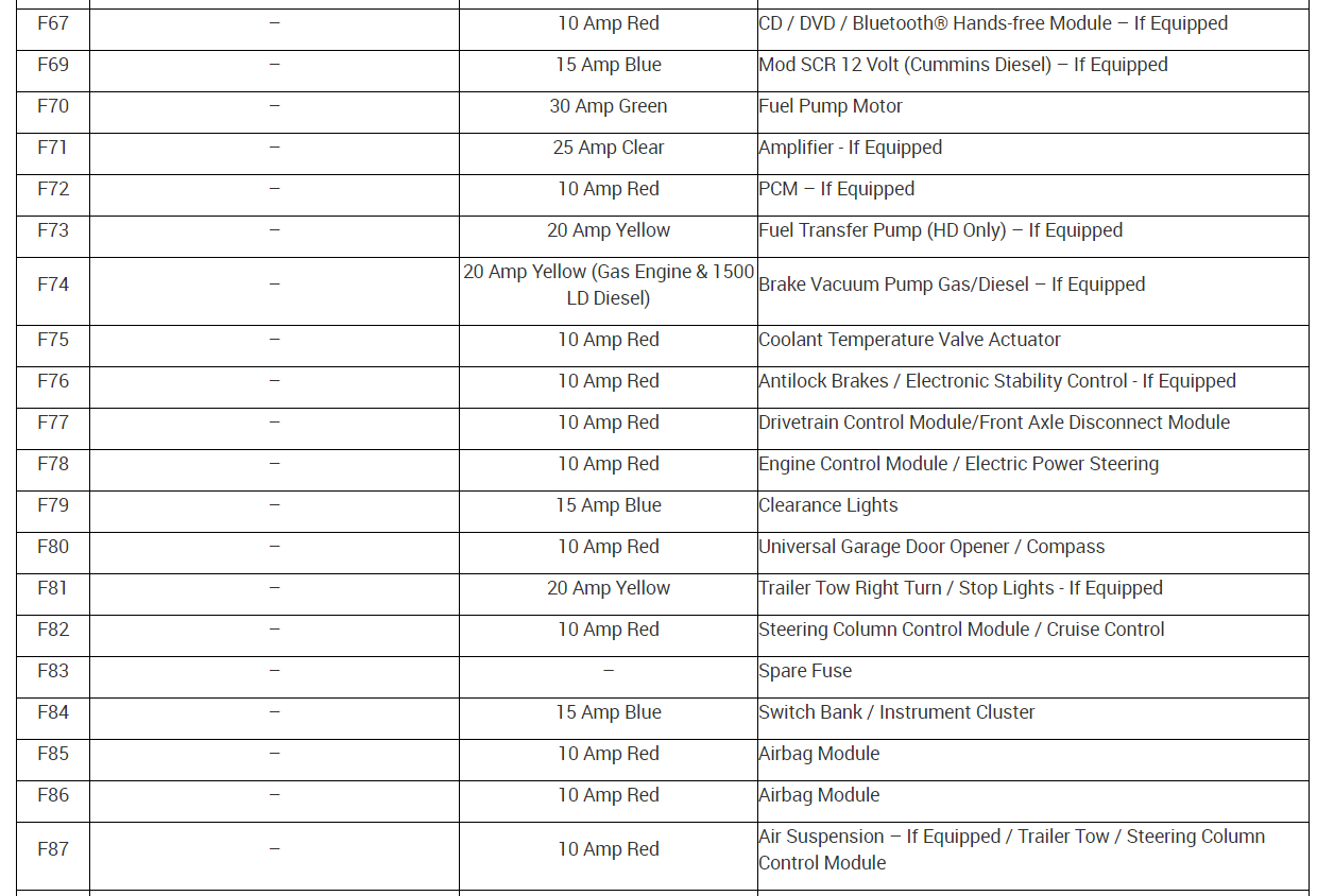

It sounds like you have a fuse (F13) , relay or blower motor that has failed but to be sure lets run down theses guides which will show us how to fix it. This video shows the job being done on a similar car but the process is the same with diagrams below to show you how on your car.
https://youtu.be/1eau7hCuuJ8
and
https://www.2carpros.com/articles/blower-fan-motor-works-on-high-speed-only
and
and

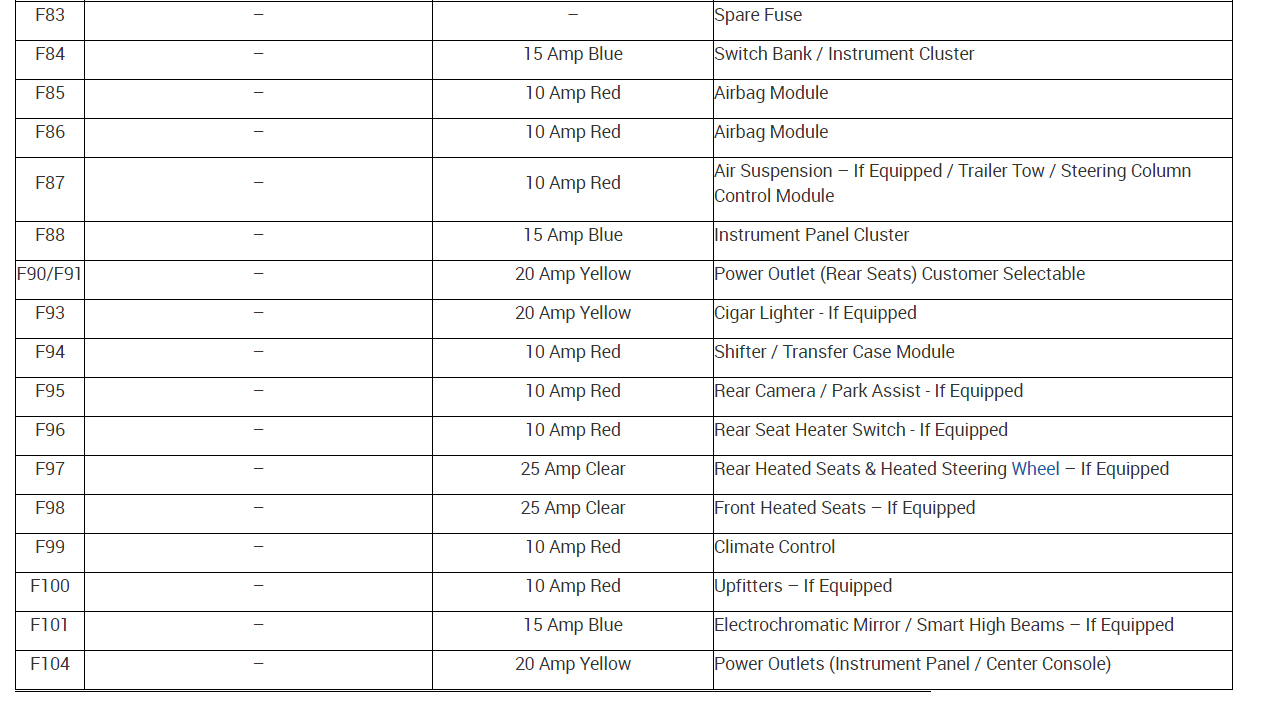

The fuse and relay location are in the diagrams below. Check out the diagrams (Below). Let us know what happens and please upload pictures or videos of the problem.

That did it, the guides worked perfect, I found out the relay stopped working, easy fix thank you.
