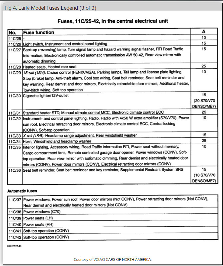

Battery was replaced. Prior to it dying, a/c, heater and radio worked. Now all do not. I found how to reset radio by leaving key on with radio turned on for two hours, then when display changes from off to code, entered four digit code that I got from dealer. But, do not know how to reset blower. Will it resolve when radio reset?
Aug 11, 2017 at 1:07 PM
  • 55,770 POSTS

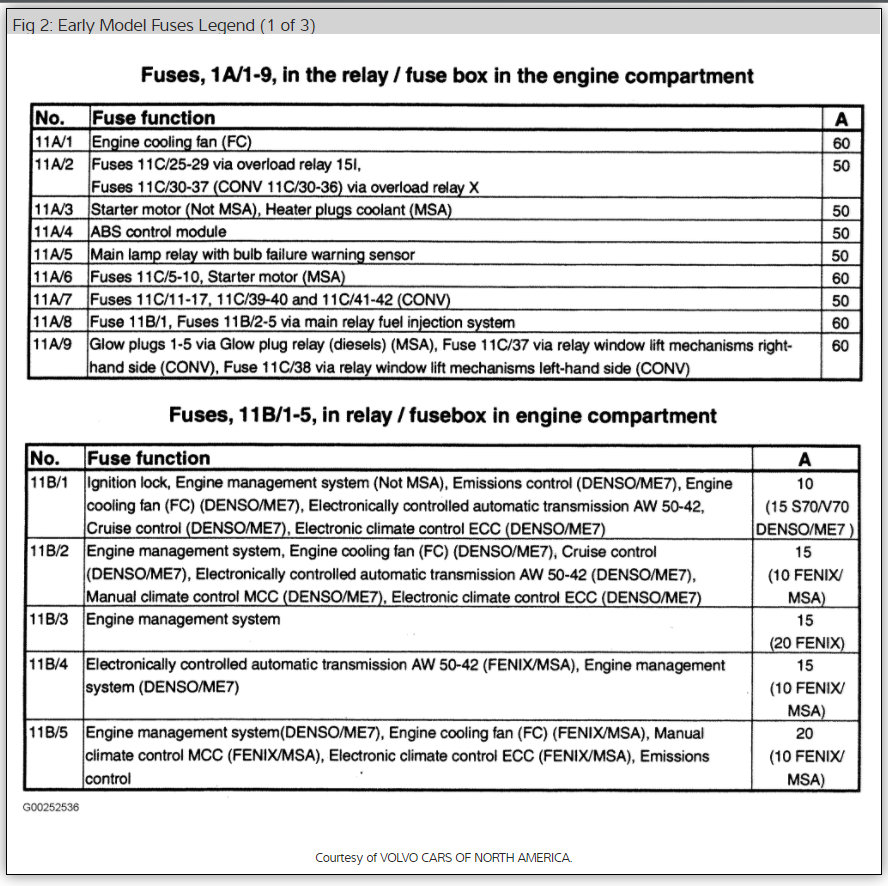

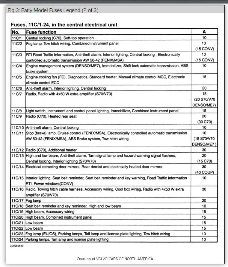

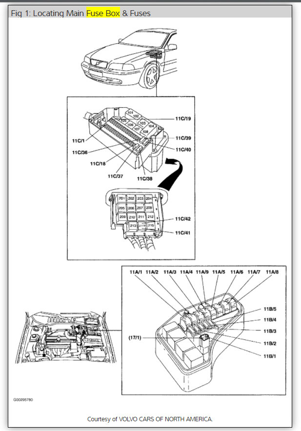

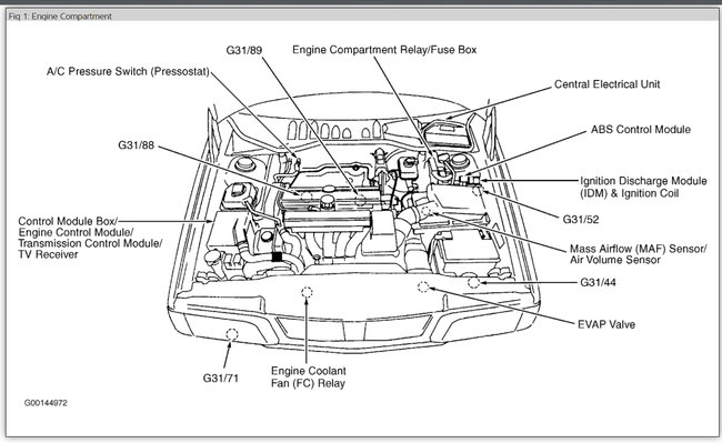

I would start by checking the fuses for the HVAC system. Here is a guide and some diagrams to help us get started getting your car fixed.
Please let us know what happens, we are interested to see what it is.
