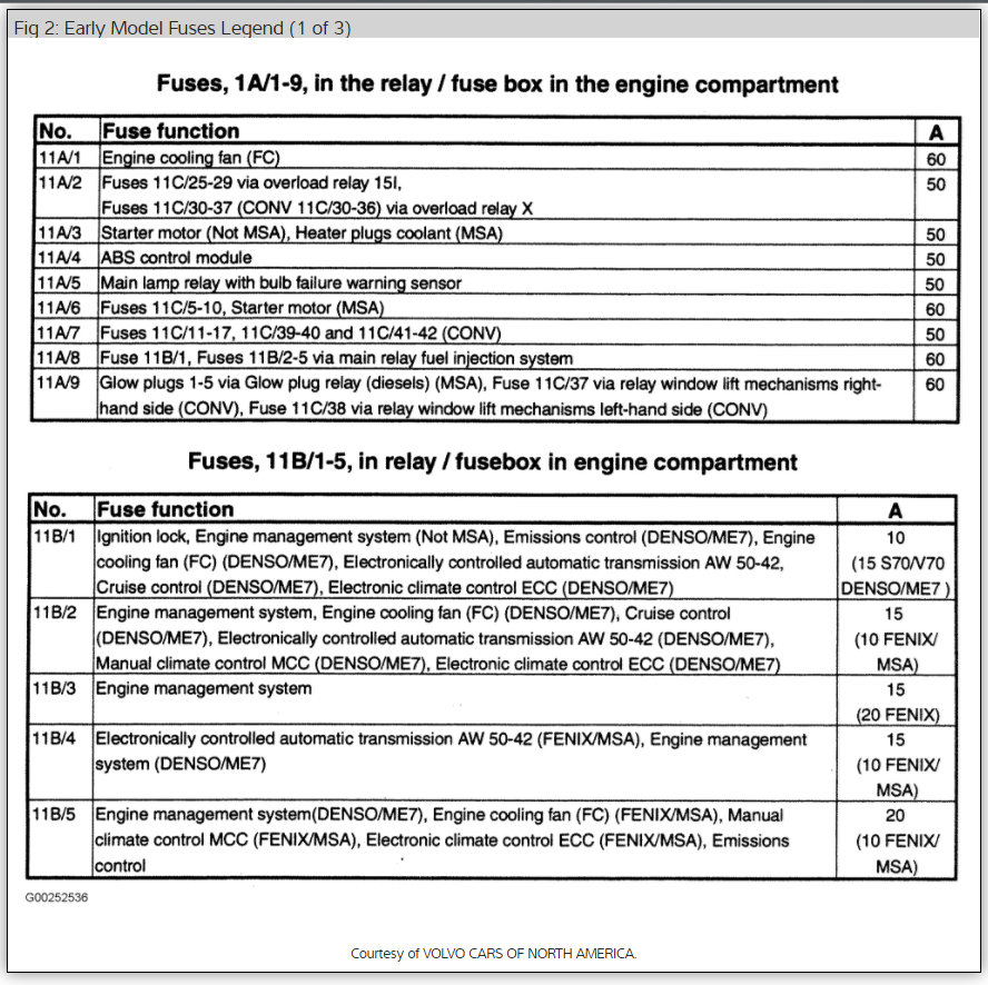

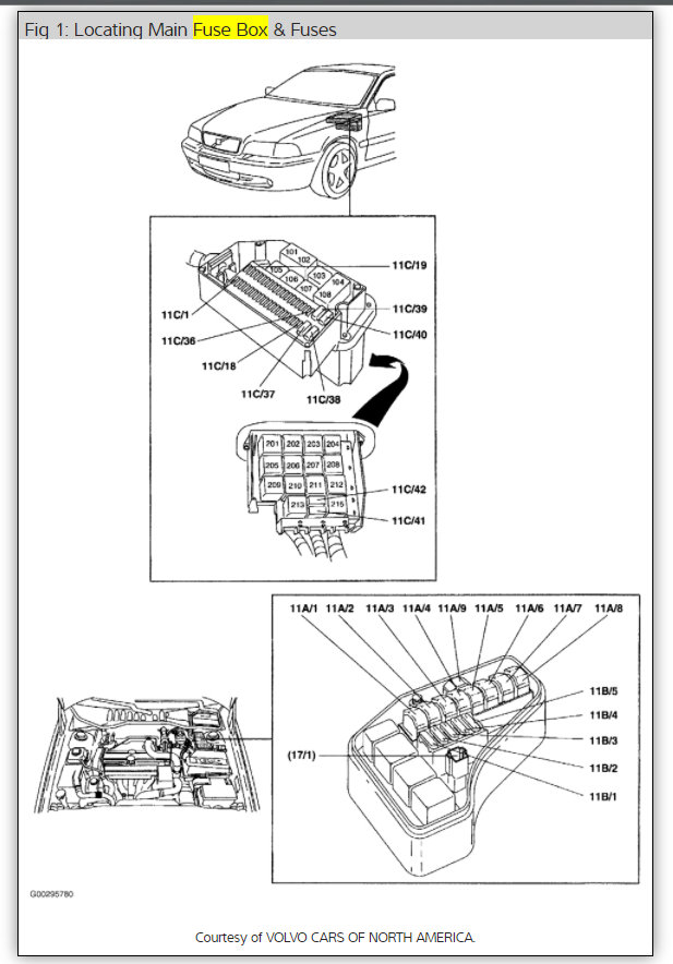

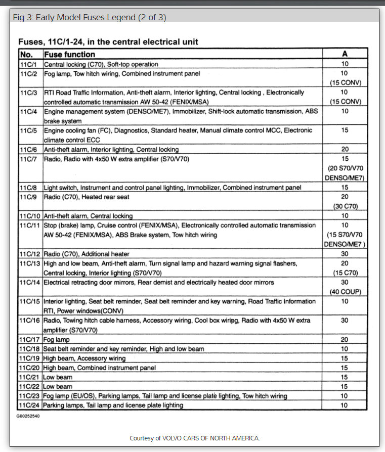

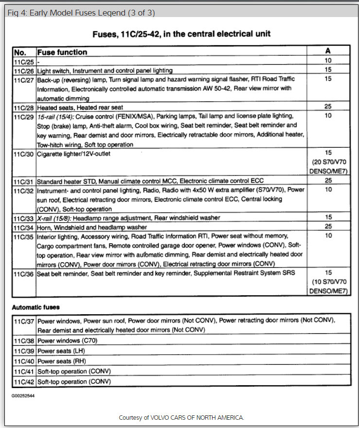

I would start by checking the fuses for the HVAC system. Here is a guide and some diagrams to help us get started getting your car fixed.
Please let us know what happens, we are interested to see what it is.
