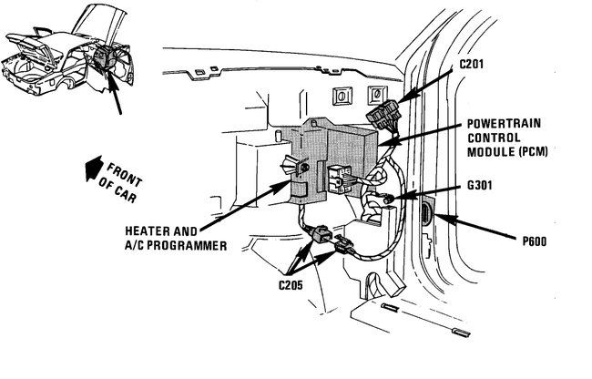

Not able to adjust temperature or speed.
Jul 11, 2018 at 9:37 AM
Experienced Mechanic
55,616 POSTS
This car had problems with the AC programmer which you can get from Amazon. Here is the location below. Check out the diagrams (below). Please let us know what you find. We are interested to see what it is.
