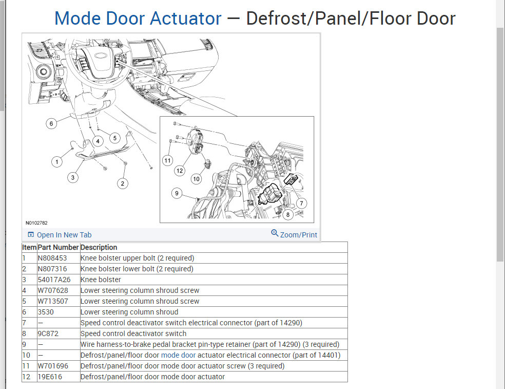

Only my defrost vents are working and the 2 vents on top of the dash. The vents facing the inside of the car and the floor vents are not working at all. The temperature and fan all work just fine when adjusted but those specific vents are not. I think it may be the mode door actuator according to research but want to make sure it is for sure that and that there is not an easier fix before I start the project.

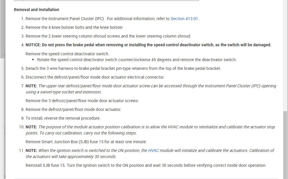

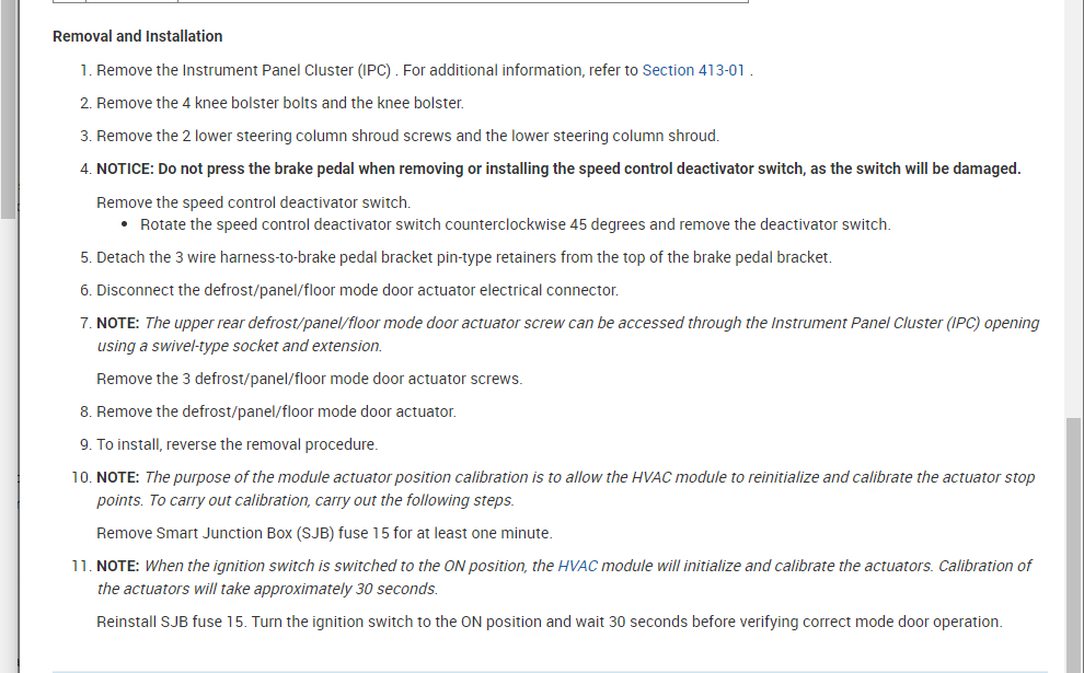

It does sounds like the mode door actuator is possibly faulty.
I have attached the replacement instruction for the mode door actuator.
