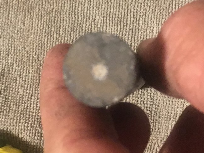

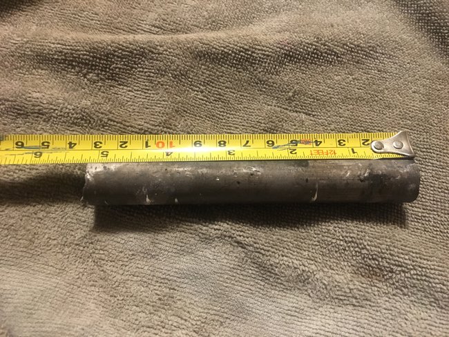

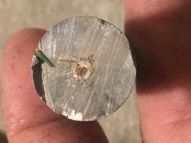

Well I don’t know what’s going on but now I have a big problem!
May 2, 2019 at 2:21 AM
G THOMPSON JR.
I his is the part that just fell out while driving
May 2, 2019 at 3:04 AM
G THOMPSON JR.
More pics
May 2, 2019 at 3:06 AM
  • 110,251 POSTS
Welcome back:

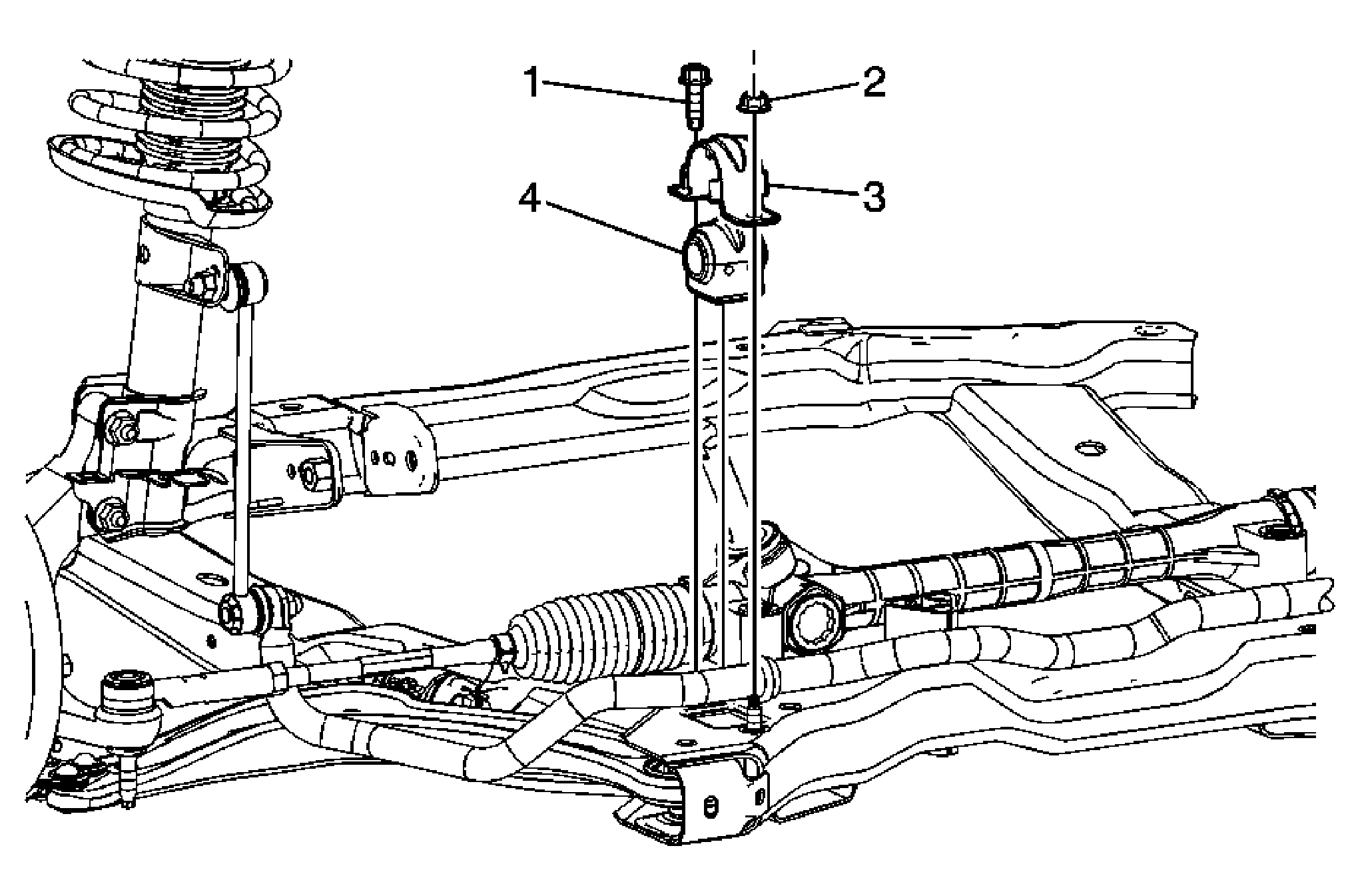

That doesn't look good. From the pic, it looks like the sway bar broke and that is part of it.
Take a look at the attached pic. It shows the how the sway bar runs across the front and attaches.
Let me know if that is the problem. If it is, it bolts under the vehicle to the frame and then to the links.
