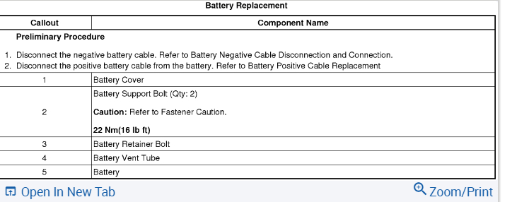

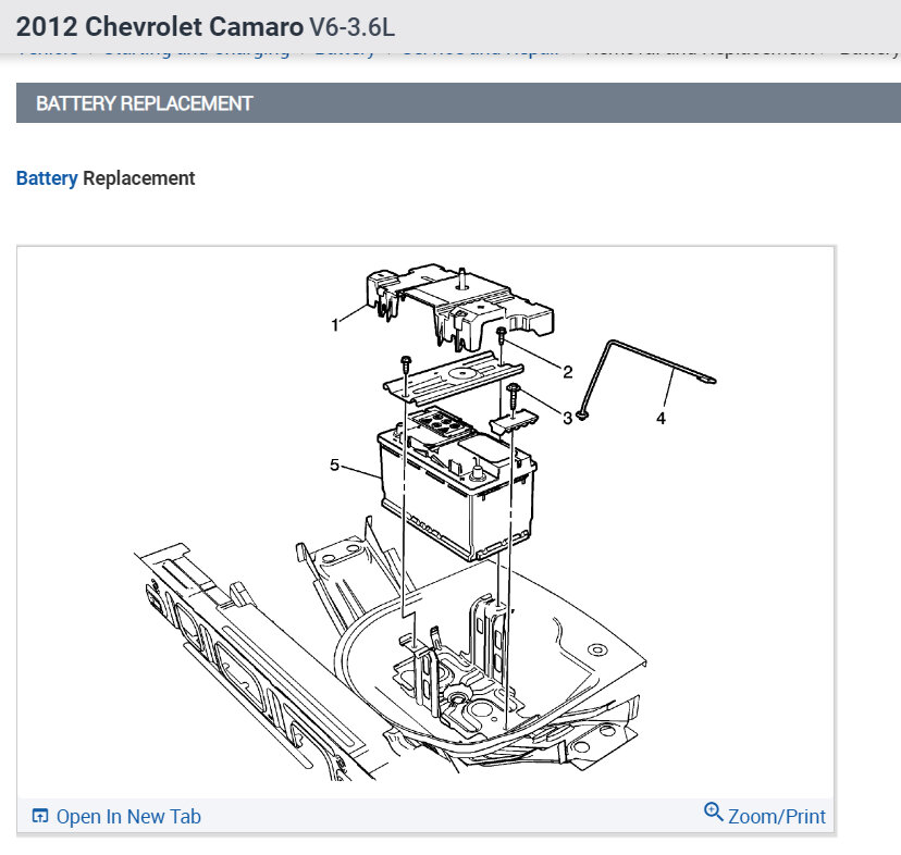

My car listed above has a clicking noise in the front of the motor where air goes in it clicks when in acc position, when turned further to try starting it does nothing.
Aug 14, 2023 at 2:13 PM
  • 55,412 POSTS
It sounds like the battery is dead. Can you please shoot a quick video with your phone so I can hear the noise? That way I can tell for sure what's going on. You can upload it here with your response. Here is a test we can do to confirm the issue:
Here is a generic guide to help you step by step with instructions in the diagrams below to show you how on your car:
https://www.2carpros.com/articles/how-to-replace-a-car-battery
Check out the images (below). Please let us know if you need anything else to get the problem fixed.
