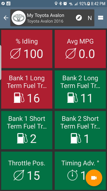

Also, I found Bank 1 long term fuel value becomes high when engine warms. Please check attachment.

Did you use the sea foam? You need a flushing agent to break down the varnish. Just changing the oil and filter is not good enough.
The long term trims are another issue. Nothing to do with the current issue. Try to see if you have an vacuum leaks. That is the most common reason for the long term trims to be high.
