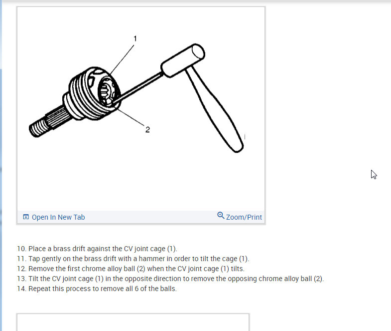

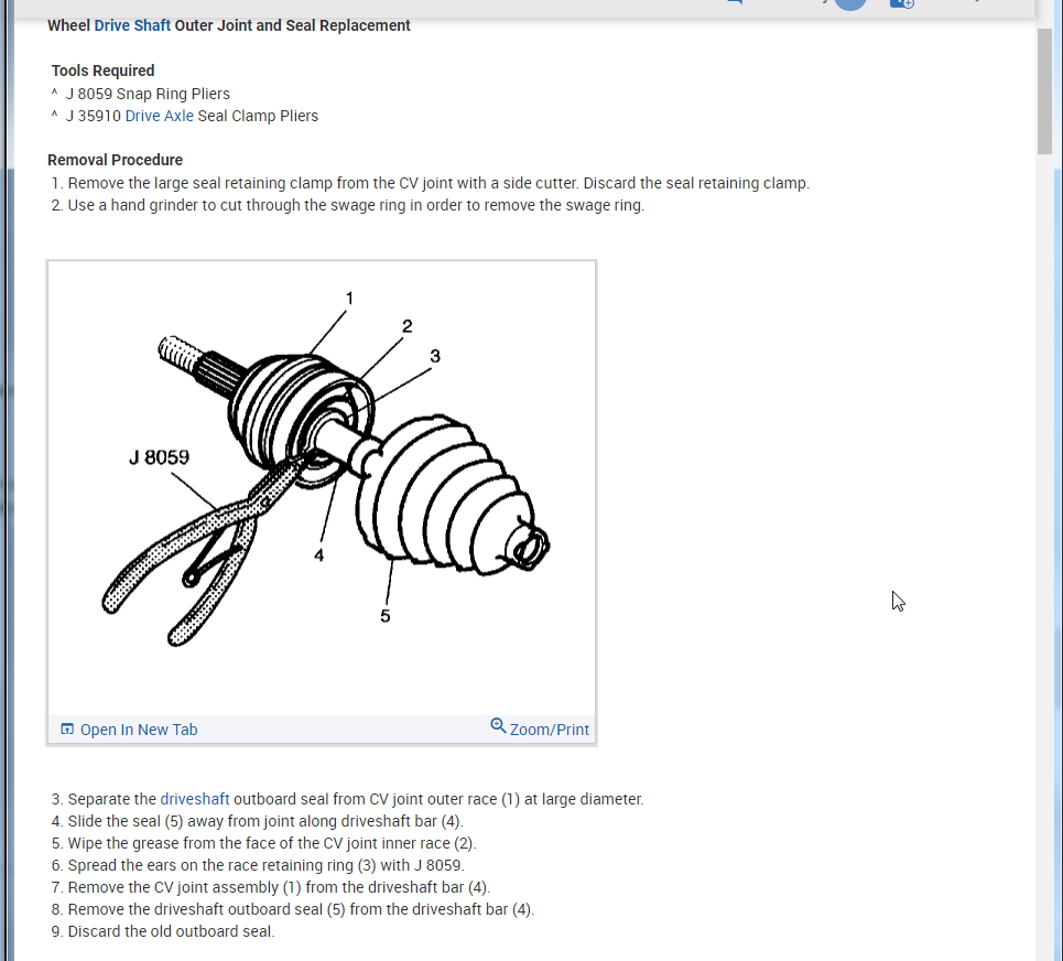

If this is happening when turning you are correct that this could be a spring/strut (more likely a mount) but the most likely cause of this is a CV axle.
Here is a guide that talks about this:
https://www.2carpros.com/articles/clicking-sound
https://www.2carpros.com/articles/replace-cv-axle

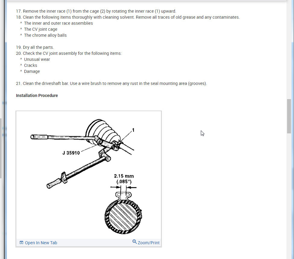

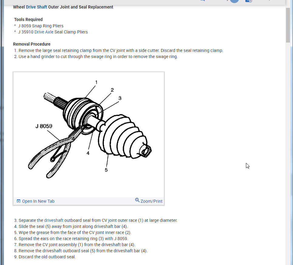

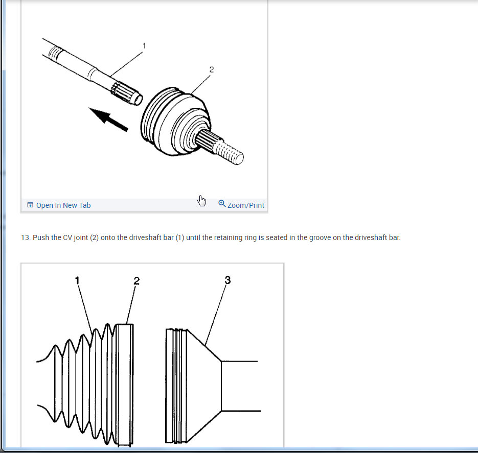

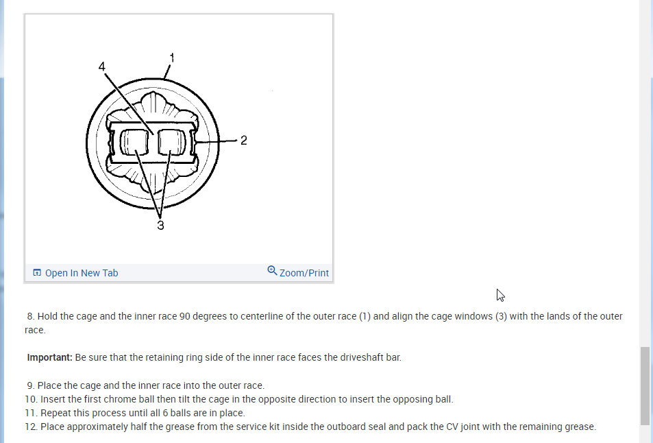

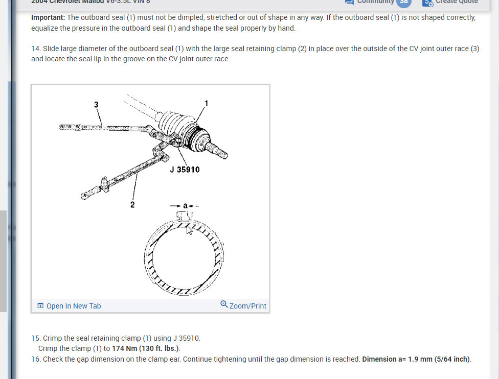

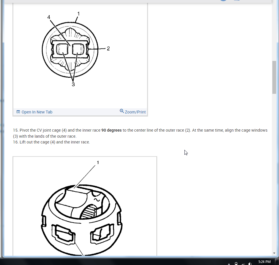

Does this make this noise on turning one way or the other? If it were me, I would be looking to replace the axle joints or the axle assemblies.
Below is the process from the manual on how to replace the axle. If this is clicking in one direction then I suspect it is the axle but let's start with this info and go from there. Thanks
