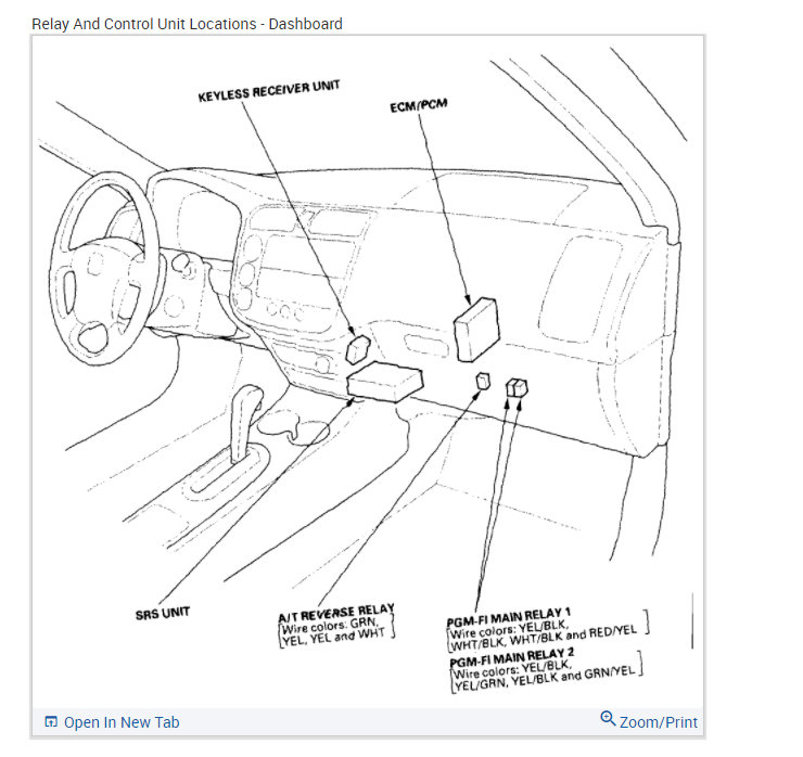

Went to start my car after just buying it a couple days ago and it won’t even try to turn and makes rapid clicking sounds from a relay behind the glove box. I looked into it and it’s supposed to be a fuel pump relay but i don’t know if it actually is. Anyways I replaced it and and it still makes clicking sounds. any ideas to fix it?
Nov 4, 2020 at 10:08 PM

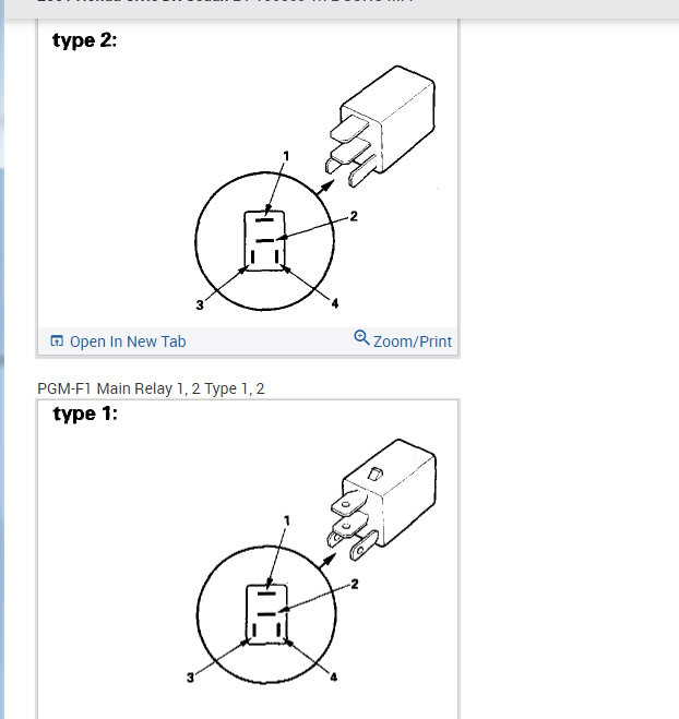

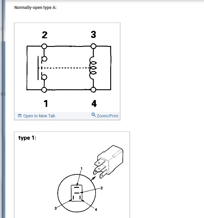

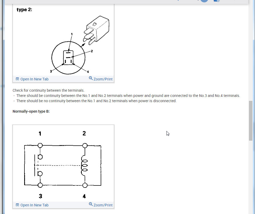

That is definitely a relay clicking so can you put your finger on them and see which one it is. Then we can perform a test to the relay and go from there.
