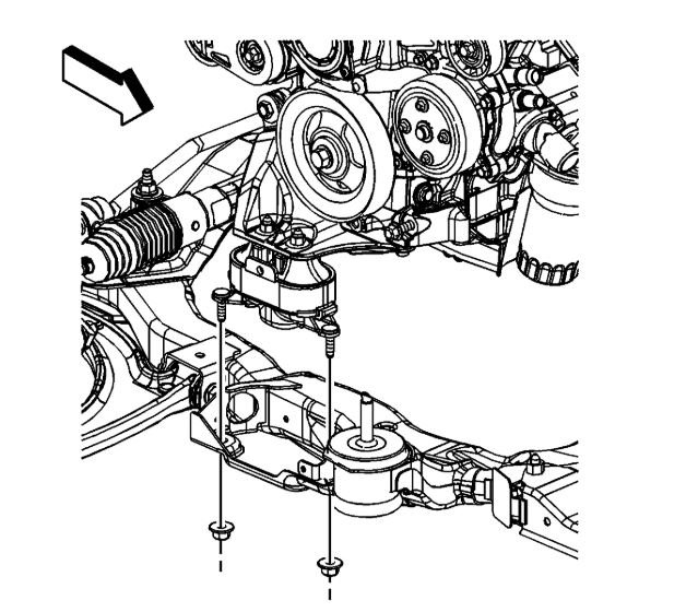

This was much better and I could hear it very well.
This sounds like the engine and transmission are moving. It sounds like a worn-out mount whether it is an engine or transmission mount. Look at the mounts and see if any have a lot of play. Open the hood and have someone put in gear several times and see if you see the engine move a lot.
https://www.2carpros.com/articles/how-a-motor-mount-works
