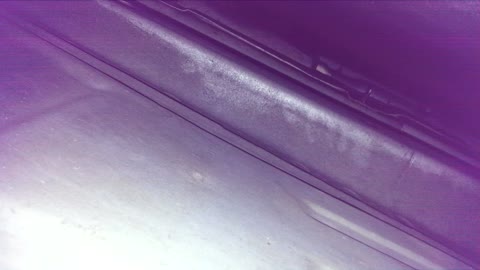

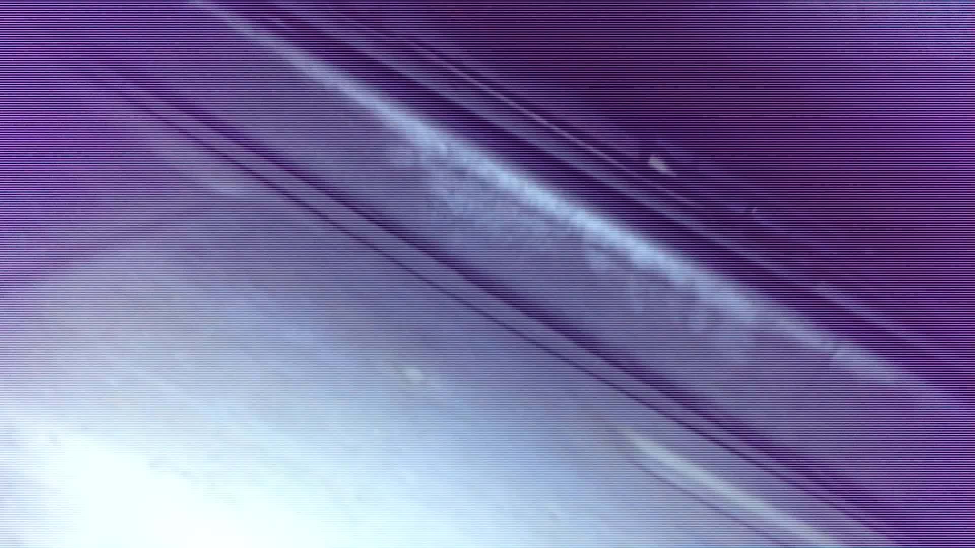

Right Roy, I just saw your message and here is the video clip just recorded few minutes ago. Honestly, I am totally sensitized to any abnormal noise, but certainly I can hear a "tick" at the end of a shift. When I shifted between N and D, I didn't hear the "tick" at the end. But a shift between P and D produced a distinctive "ticking" noise. If no one said anything, I would not have noticed it at all. Should it be a concern?
May 22, 2020 at 12:39 PM
This was much better and I could hear it very well.

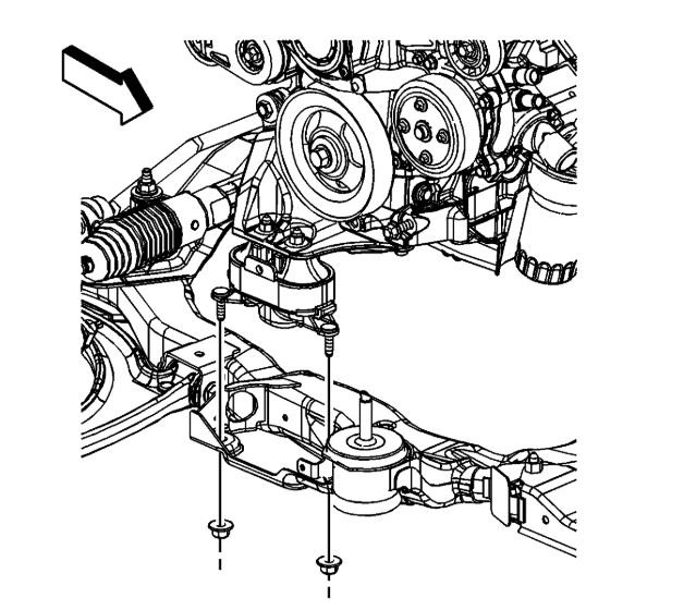

This sounds like the engine and transmission are moving. It sounds like a worn-out mount whether it is an engine or transmission mount. Look at the mounts and see if any have a lot of play. Open the hood and have someone put in gear several times and see if you see the engine move a lot.
https://www.2carpros.com/articles/how-a-motor-mount-works
