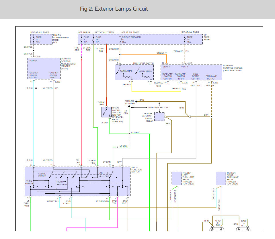

With engine running and also when not, I hear a clicking noise, like a turn signal is on, although it is not on. every thing works fine, But clicking noise continues, except when I apply my brakes.
I thought of the Light Control Module, and also the Flasher.
Can you help me?

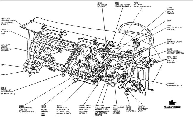

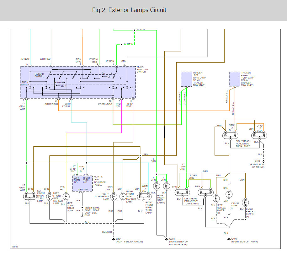

There is no turn signal or hazard signal flasher for this car because it has a lighting control module that job. Here is the location of the lightning module which is located under the dash and blinker wiring diagrams as well.
Here is a guide to help you do some testing:

MZCINKY
i bought a flasher for my blinkers as suggested (thanks guys) and i cant figure out how to get the panel off from under the driver side dashtop locate the flasher so i can replace it. i was told it is next to the steering column but i cant get the cover off so i dont even know if i got the correct one
Jan 13, 2021 at 4:08 AM (Merged)
LEGITIMATE007
  • 5,121 POSTS
Seating area, driver side, behind dash, mounted on passenger side of steering column
MERLIN2021
  • 17,250 POSTS
Where the dash meets the underpanel remove the three screws, then closer to the pedals there should be a plastic screw in the middle of the panel remove that, pull panel down and towards you...
