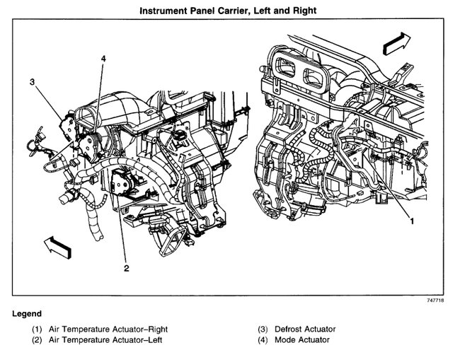

POLLYR4U
Loud Clicking noise when I put the heat on the feet area and/or the defrost or heat is turned completely off. There is no clicking noise or problem when the vent is toward you and you/floor vent. Basically there is no problem when the heat option has AT LEAST one of the options as the heat going towards your upper half. But if there option is not one (aka only defrost, or only towards the feet and also when the heat is turned completely off) then the loud clicking noise occurs.
Jan 21, 2014 at 1:34 AM
SATURNTECH9
  • 30,869 POSTS
Sound's like you have a bad mode door actuator or broken mode door your going to have to get in there and see which.I would say most like the actuator not uncommon on those cars.
These guides will help fix it
and
Jan 21, 2014 at 2:06 AM

J641350
  • 6 POSTS
ac is working on passengers side blows nothing but heat on drivers side suggestions on how to repair?
Jun 20, 2020 at 3:31 AM (Merged)
HMAC300
  • 48,601 POSTS
This is common when the blend door actuator goes out this guide will help walk you through the replacement steps with instruction in the diagrams below to show you how on your car.
Check out the diagrams (Below). Please let us know what you find.
