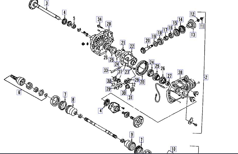

  • CAR REPAIR CONTRIBUTOR
Breakdown of the differential assembly.

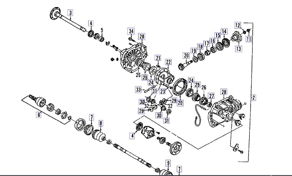

Okay, I attached an exploded diagram. Number 5 and 27 are the support bushings for the axle. They keep the axle stable.
The carrier bearings are for the carrier assembly and yes it is adjustable, but only to adjust gear lash. Not the axle play.
