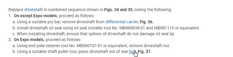

When I accelerate there is a loud clicking/ticking noise. When the vehicle is in neutral and I rev the engine there is no sound. It only happens when I press the gas and am in any gear and gets faster as I go faster. If I am driving and take my foot off the gas the sound goes away. This just happened and I’m confused on if it’s the CV axles or something in the transmission. I placed the car on jack stands and visibly see the faster the CV axle moves the faster the noise and then the CV stops the noise stops unfortunately the noise sounds louder on top by the flywheel. Do the CV axles only move when the gas is pressed? The noise is only when I press the gas. Any advice?

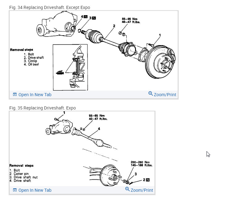

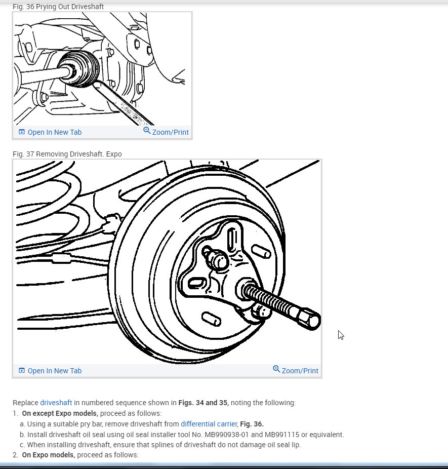

Clearly it is a rotational noise so that means it is either the axle itself or the differential inside the transmission as that is the only two things spinning at that rate.
If it were me, I would remove the axle shaft and inspect the CV axle and then retest the vehicle the same way you just did on jack stands.
Let me know what you find but this sounds like a bearing noise that is most likely in the differential inside the transmission.

Replaced CV axles and noise is still there going to have to open transmission I believe at this point.
