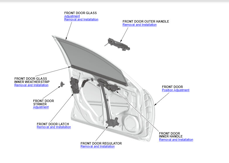

I'm sorry, but even holding my computer against my head, I can barely hear anything. It is common for a failing air flow actuator to make a clicking. However, it is usually much louder and faster. Are you experiencing any issues with airflow directions or temps?
Inside the door, there really isn't anything that would create a clicking. How long does it take to stop? Is there any time that you don't notice it or is it all the time? I ask because if you are using the A/C or defroster, it could be pressure equalization in the evaporator. That is just a thought.

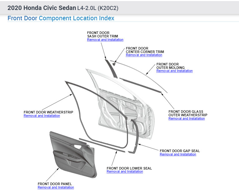

It could be something expanding or contracting due to temperature change. I attached two pics below showing the door components. There really isn't anything in there that would cause a click. Take a look.
See if it changes or stops. Let me know and if it does get more pronounced, let me know and we'll take the trim panel off and see if we can locate it then.
