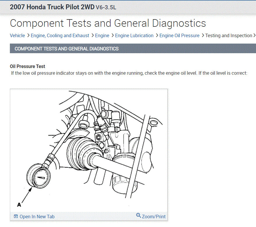

No, we haven't checked the oil pressure. how do we go about doing that?
Apr 22, 2021 at 11:50 PM
  • 110,248 POSTS

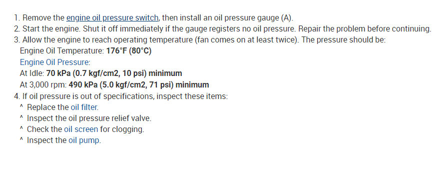

You will need a mechanical oil pressure gauge. Most parts stores will lend you one. All you do is remove the electric oil pressure sensor and screw in the mechanical one. If you look at the attachments below, they include the directions specific to this vehicle for testing. They also include the manufacturer's specs.

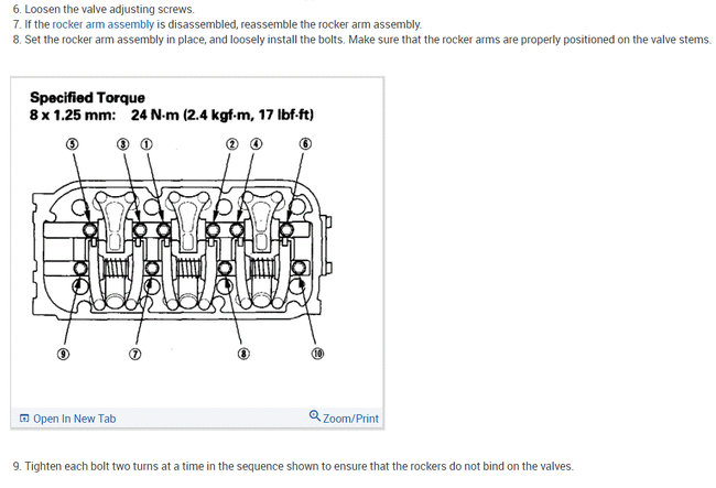

Hi, so we did the oil pressure test and I checked out good. Do you have a diagram on how to check the lifters?
Apr 25, 2021 at 3:43 PM

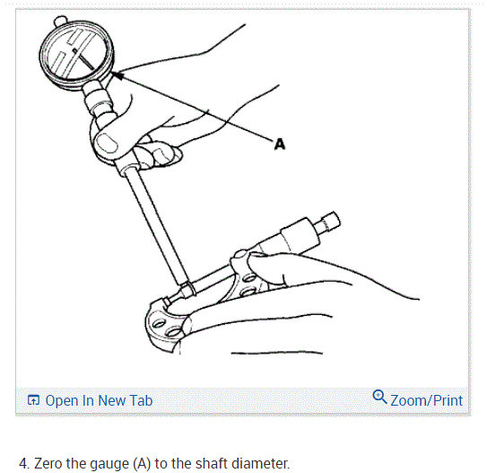

  • 110,248 POSTS

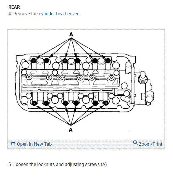

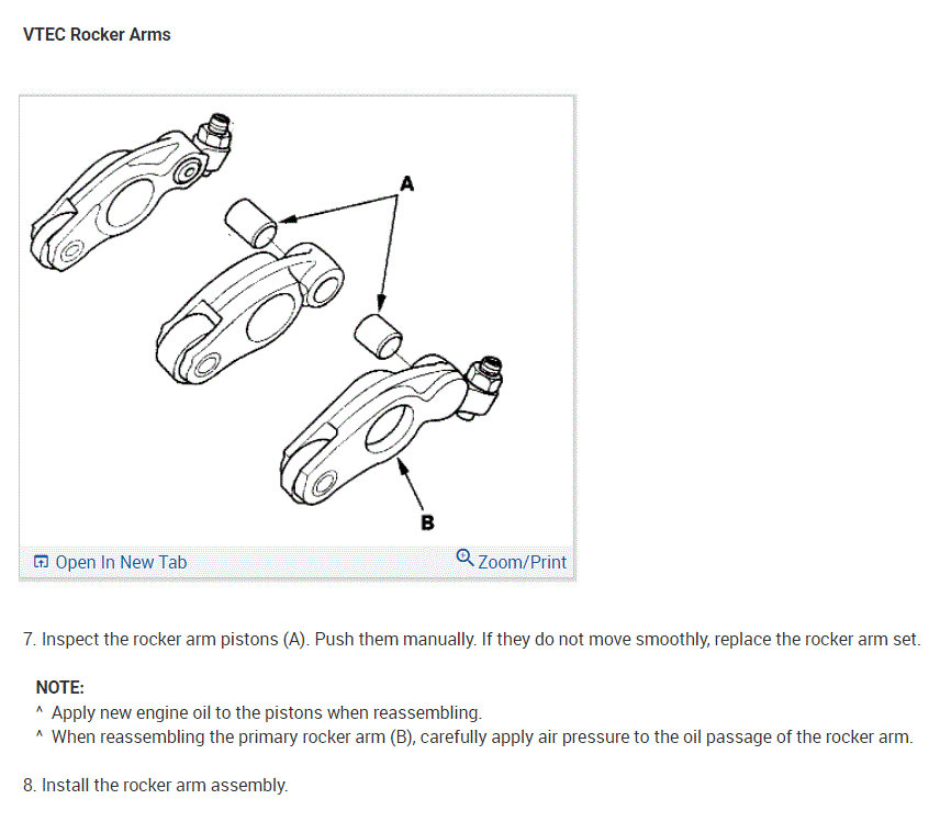

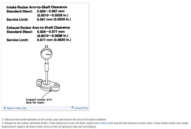

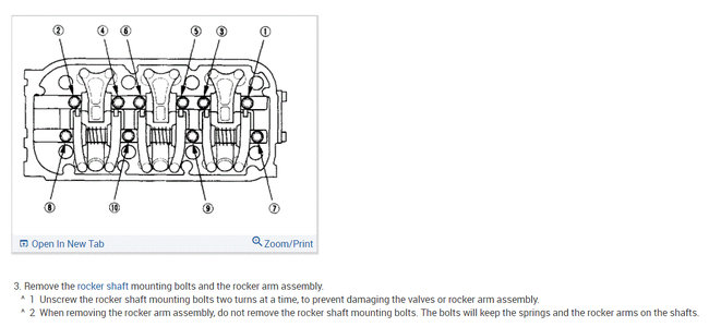

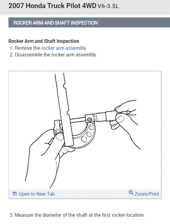

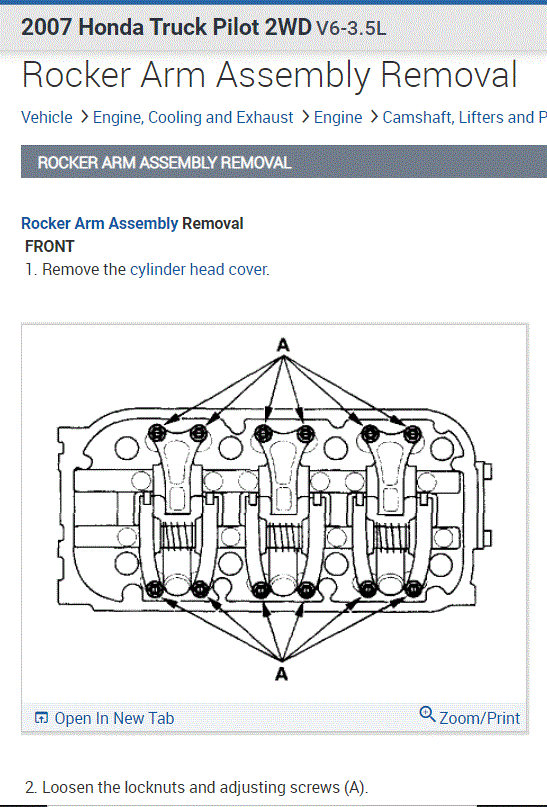

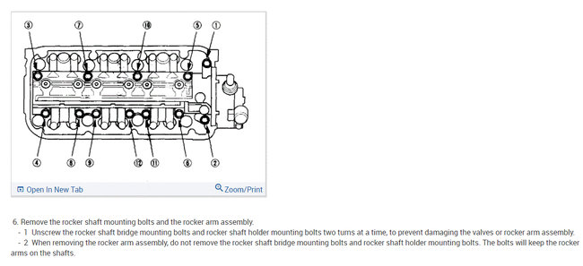

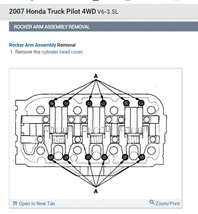

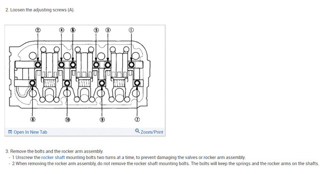

The only thing is the rocker arm inspection. Take look below at the attachments. They explain how to test them.
Let me know if this is what you wanted. Also, the last two pics explain how to remove the rocker arm assembly.
Apr 26, 2021 at 12:20 PM

Yes, you can do it that way. However, do you notice any play in any of the parts that could cause the noise? It could be a few different things. A worn camshaft or even what I mentioned earlier. Check things out first to confirm something feels loose. When you do, make sure the valves for that cylinder are fully closed so there is no pressure on the rocker arm.
I attached the directions below for the removal and replacement of the rockers. The last pic is the replacement. It starts on number six because it was from camshaft replacement directions. They don't have it listed separately.
