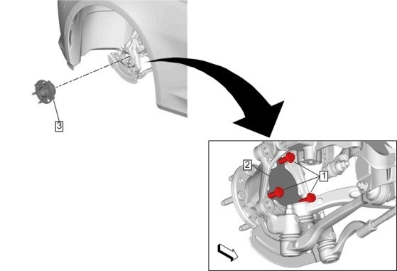

Left front wheel clicks when making a right turn frontward and backwards.

That could be several things, loose lug nuts, brake pads, wheel design, (not sure which ones you have, but if they have a plastic center cap, they can make noise) wheel bearing. Have you taken it to a dealer? It should still be under the bumper to bumper warranty.

Thank you for your reply. We have had the car to the dealer twice for the same thing. It is a metal sounding clicking when you turn the wheels coming from the left front. The dealer thought it was the brake clips but that is not it. It goes back to the dealer Tuesday. Thank you again for your reply.

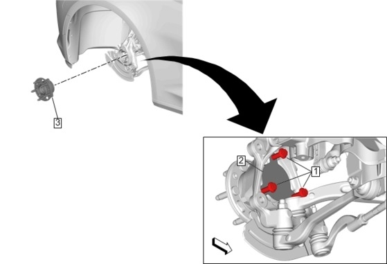

Hi again. No problem. I really did not help. However, if this is only happening when you turn the wheel and the car begins to move, my first suspect is the wheel/hub bearing. The bearing is what the wheel attaches to. I attached a picture of one for you to see. It is number 3 in the upper left component picture.
