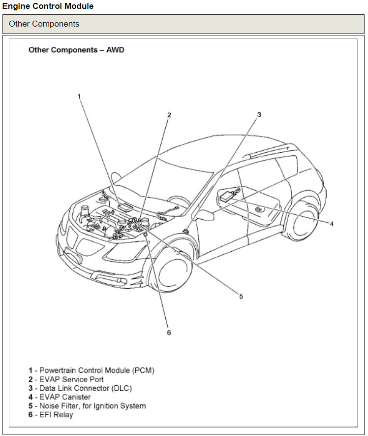

Car will not always start. I have to pull out the EFI relay and wait. The car will start clicking sound and then I pull the relay and wait about ten minutes replace the relay and it starts.

This is telling me the PCM is bad because when you reboot it it works for a bit then stops working just like a home computer that is having problems. Try a used PCM and plug it is to see what happens.
Here is the location.
